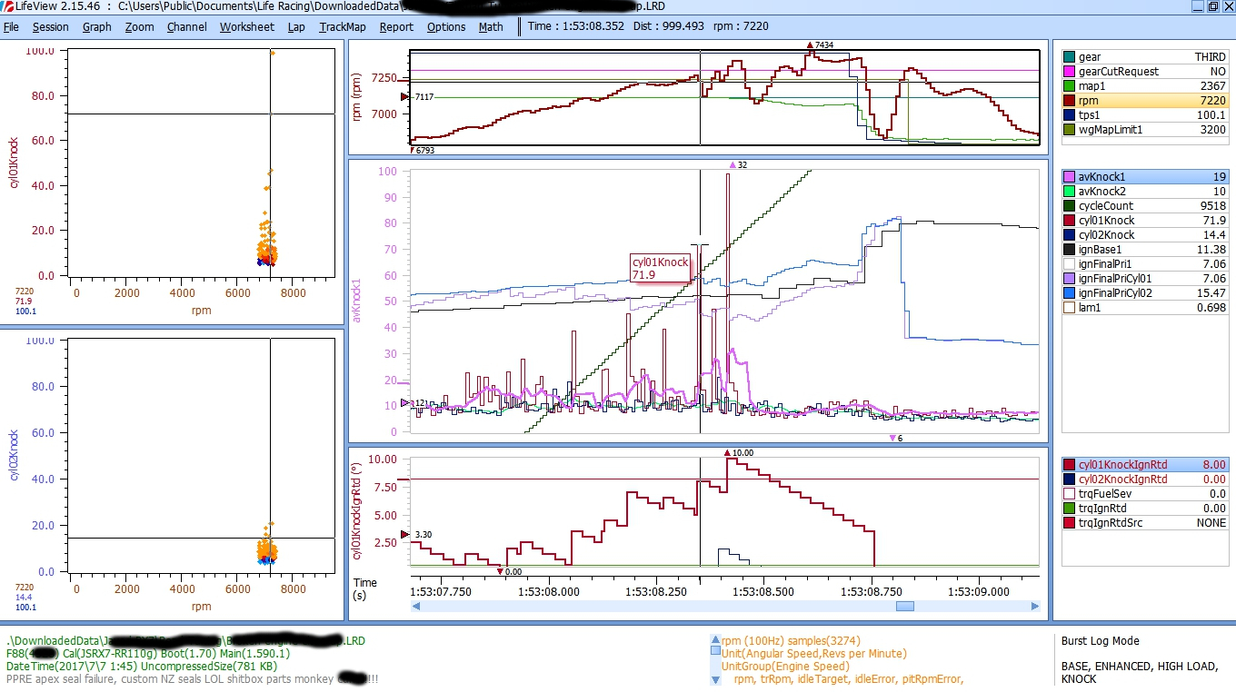

What I have found:
You do have to use the right knock sensors
All software settings need to be specific to the rotary engine (which are quite different to 4cy to 10cyl reciprocating ones I do)
I tested my own knock sensors with a peco scope to get the right frequency on an actual engine first
Then followed the basics given to me by various engineers at LR
There are some specific items that make it unique but ironically I find it actually easier on the rotary than on reciprocating engine as they are mechanically 'quiet' by comparison so once you have your knock thresholds set correctly to suit and all other things done (see Ryan's video on subject) then its not too hard, and you wont break engines working it all out either
Here is one of the many set up worksheets I use, shows it working and I record every individual cycle of the engine too
You do have to run things a certain way to have no knock on action of rev limiters and traction control, once done it all works perfectly, as proven in this car.
Its not usable without the TC by the way, 275 wide R888 tires, still have to limit boost in 1st gear = ~100kph at 9100rpm. 2nd gear use full boost but needs the TC to keep her going at the rate in that video !

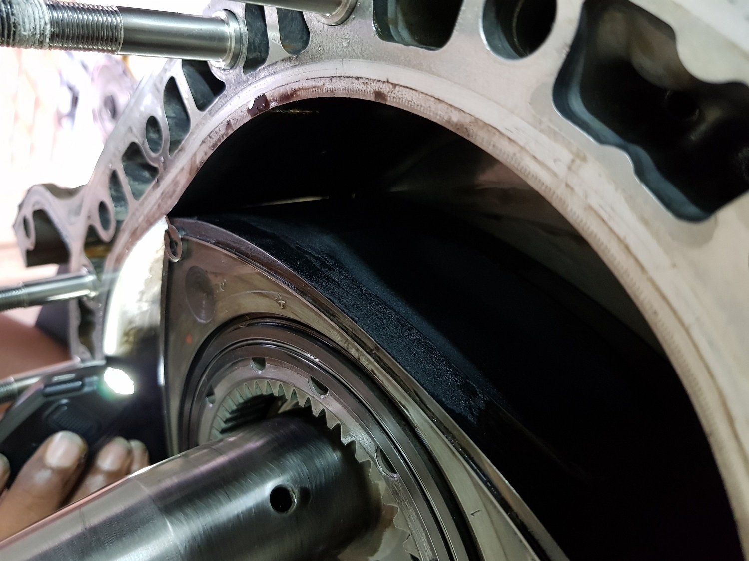

^ That part needs some more detail which upon re reading. The knock was 'out of control' (due to component failure inside the supplied engine) the ECU however did control the following pre ignition event trigger and shut down that part of the engine on the following engine cycle, thus preventing any additional damageRICE RACING wrote: Fri Sep 15, 2017 1:29 amNot specifically no (only one had a 'soft failure' read below)Mark_r33 wrote:Have you turned (m)any into hand grenades during the initial setting up of your knock control strategy?
I've always heard that the rotary is very easily upset by any knock, so would be interesting to hear how you go about dialing the knock sensing in in a properly "safe" manner.
That Mazda looks pretty savage!
There was an engine supplied by PPRE that used their brand of product that had a failure within 250km run in period, that one had run away knock that was not able to be controlled by the ECU ....
So turbo rotary engines do tolerate quite a lot of knock and pre ign as well.
Attached: This is what the run away knock looked like and the root cause of it, again all bare the sub par sealing parts distorted during run in period which cause the hot gasses to leak back into the preceding chamber were totally fine and thus reused. Had another case with the same user who tried another set of equally dodgy parts, lasted a bit longer but again same situation, gas leakage around this time a worn out leading edge causing sever gas leakage and resulting in equally high knock readings, and again the pre ignition event trigger saved any further engine damage.
p.s. Seen the same thing (gas leakage) happen in various piston engines which results in the same high knock readings which then lead to pre ign or super knock events. Shown up during leak down tests, and again thorough initial set up of the knock control system prevents any further damage happening to the engines. It's the best thing about the Syvecs that you really can make the engine live through what on inferior offerings would have resulted in the whole motor being a bin job.

In the picture of the rotor, is that something melted onto the rotor, or has the actual rotor melted a bit there? Bit dark to tell in the picture on my computer is all?

Nothing melted, pic shows light passing through where there should be no light (part failed) so gap between seal and outer housing.
