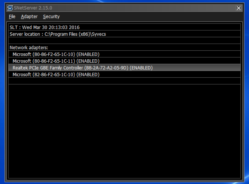

Hi all, I have installed the latest version of the software onto my Dell inspiron 15 7000 with windows 10 and cannot connect to the ecu. I have changed the settings for the ethernet port to not sleep but still no luck.
Everytime time I search for the ecu in Scal it just says no devices found.
No idea what to try next, only to check my ecu has power as this is the first time the ecu has been powered up after the rebuild, although everything else is working fine.
S6GP ethernet to Windows 10 laptop

Thanks for the reply, my problem may be related to not having a 12v switched ignition feed to the ecu! Once I get this sorted I'll try again.
Re: S6GP ethernet to Windows 10 laptop
Even though the ethernet driver was not installed the software connected to the ECU without any problem. Once you power up the ecu i think your ethernet controller will connect to the ecu as well.

It seems to be a bit of a problem.
When mine will not connect ( it applies wired or wireless )
I just re-install SSuite and it works again. Just annoying to have to re-install multiple times.
There probably is another way, but this works for me
littlefella
- Posts: 14
- Joined: Wed Nov 09, 2011 9:11 am
Have you allowed SCAL/SCFG and other programs through the firewall?? You can test by switching off the firewalls (switch all off).
