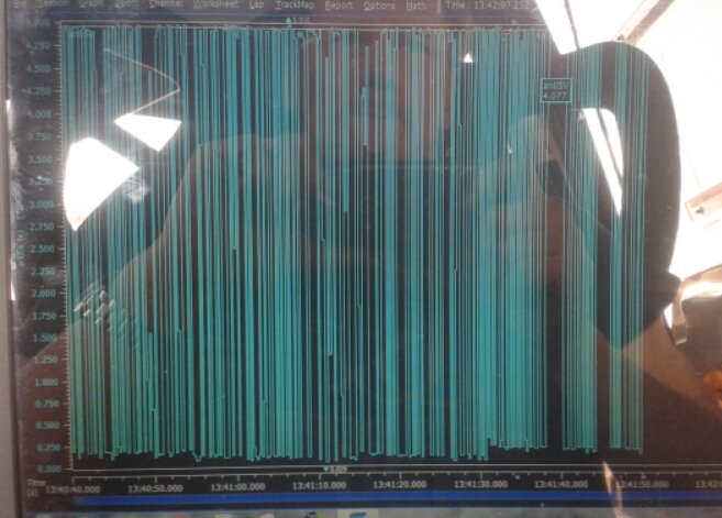

At the track and tested. Speed seems stable with the filtering, but logging on thermister / an05 shows massive fluctuations.
See pic. At constant speed or idle the voltage is flipping from 4.98 to 0.1 for example.

obviously the voltage at speed will be switching high and low, that's just how the sensor works.
When stationary though it definitely should not be.
