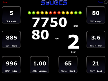

Hello All,
You may have seen there is a Syvecs app now available on the Apple App store.
The initial release uses either the stack stream or a fixed custom can stream via rs232 output, this is via the Syvecs Apple approved bluetooth module. The fixed can profile is based on the most commonly used setup from Syvecs.
I am currently working on a new release that has the following features :-
* User Assignable Display Output
* User Configurable CAN profile
* High / Low Peak Values
* Unit Selection
* Calibration Switching via PWM output
* Traction Control Switching via PWM output
* User Configurable Switch Output via 0-5v output

Little update 8-)
The output function is now working from within the App, there are two available that can be used for calibration and traction control switching with ten positions for each, just need to finish up the interface, this uses two inputs on the ECU.

Good job! Now I can switch to ipad from carpc.
I doubt I have spare input. Which inputs it uses and why two?

secure wrote:Good job! Now I can switch to ipad from carpc.
This version allows you to replace the two inputs into the ECU that you are currently using for calibration and traction control switches.

I can't rotate the screen on IPAD mini? No landscape mode on ipad mini?

Works OK here on my mini, which screen are you trying to rotate and which version you running?
EDIT: which iOS version also?

It was the latest Syvecs version. I just updated to latest ios version and it works now!
Regarding for the interface. can we use custom shiny gauges in the future like that? :D

I am currently working on a new cross platform release with more features ;)
