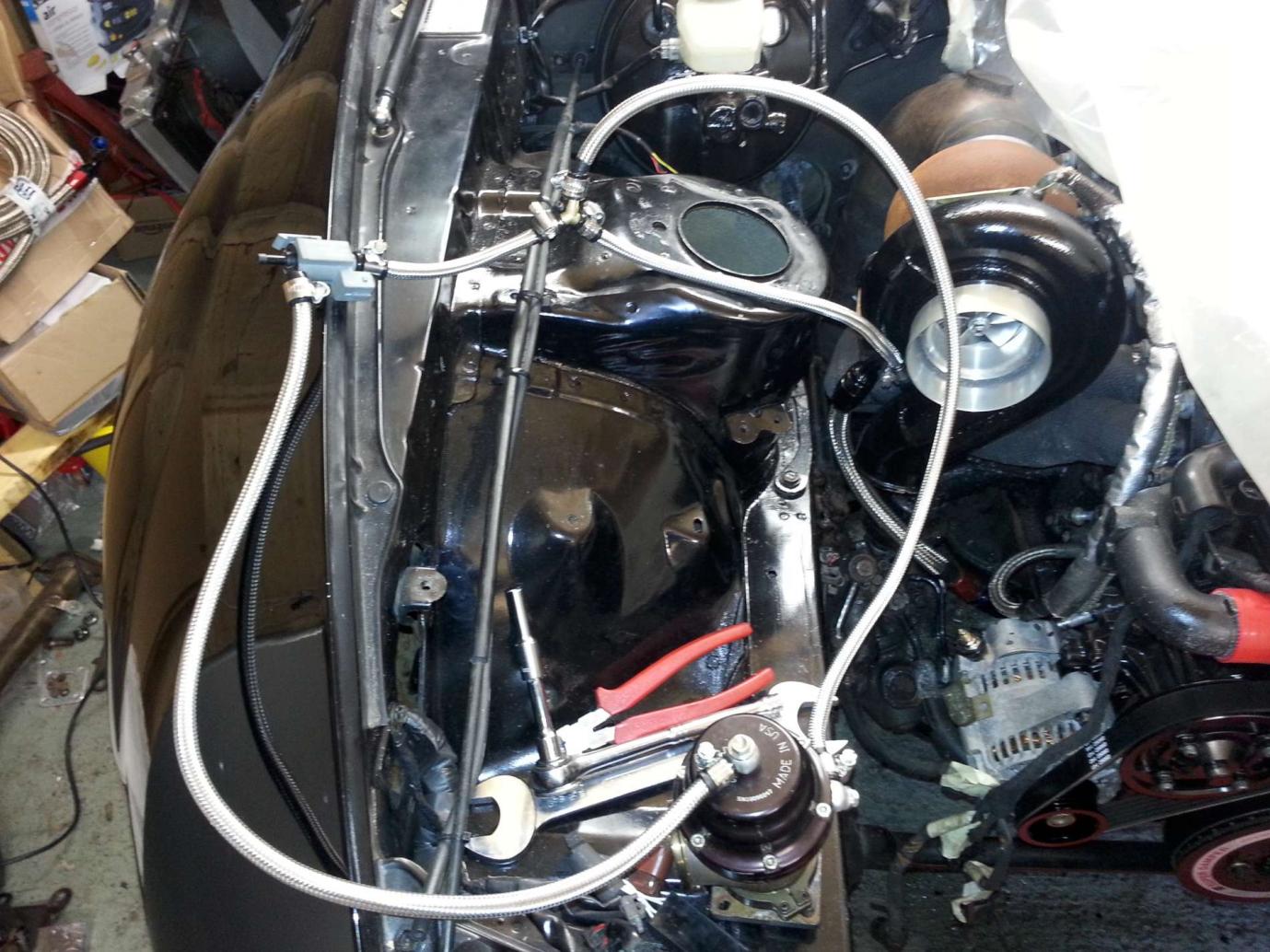

Just looking for some confirmation that what I have here is in fact correct....
Summary:
Turbo compressor pressure split to solenoid IN (metal port) and wastegate lower side port.
Solenoid COM (side of the solenoid) to wastegate upper port.
