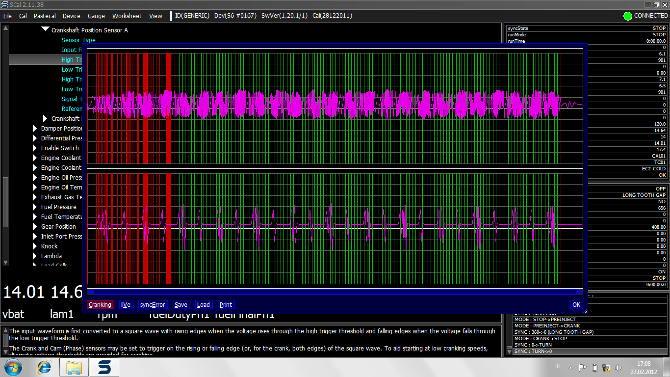

Re: help for starting
When I checked the logs i saw Long tooth gap error so I thought it was calibration fault but probably a fouled spark plugs. will see this next week...
- eee.txt
- synclog
- (208.26 KiB) Downloaded 1780 times
- sync
- 3.png (112.35 KiB) Viewed 39510 times
