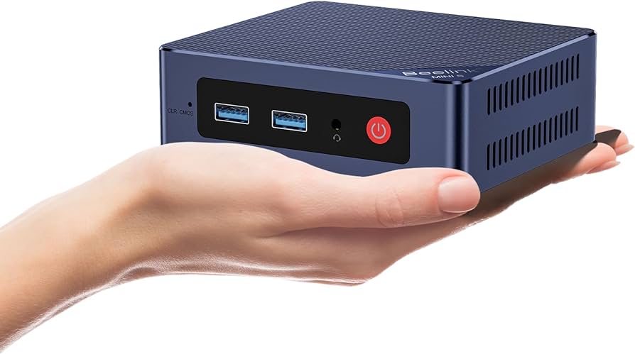

My solution.

stevieturbo wrote: Thu Oct 05, 2023 7:17 am Can you get it to log automatically ? I'm sure some sort of script or program could do it ?
Yes, you can actually run the script when Windows starts but I do prefer one click button in Realdash.
Now I'm trying "wake on lan" but couldn't make it happen yet. When the ignition is on Syvecs might be sending some packages through ethernet ply. This could auto start the computer. Not sure if it must be a magic packet or not. I'll update the bios soon and see if it works.

secure
Posts: 254
Re: Increasing logging capacity for endurance races
Post by secure »
Yep alternatively if you set the computer wake on power, a simple on/off button would do the job.
I've no headunit nor physical gauges in my car so running pc is a need for me. Voice alerts, visual alerts is good for trackdays. :)
