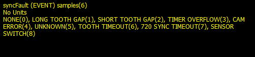

Open you error flag channel in SView, highlight this channel. On the bottom of the screen will be the decode for the channel. In my case it is the channel syncFault See below bottom screenshot.
In brackets is the hex value of each fault, get your trusty Programmer calculator and from there you can see what bits are active for each fault. In this case Tooth Timeout(6) will be bits 1 and 2 active or 0x06h
That should work..
That should work..

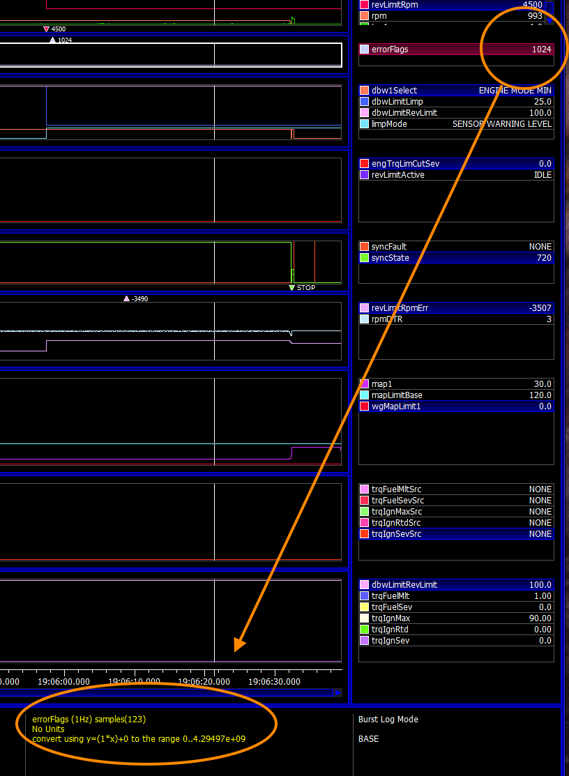

@littlefella thank you for looking.
I've attached a screenshot with the cursor on limp mode; error flag is 1024 (lambda 2 in my case) and limp mode shows "sensor warning level".
I'm not seeing the decode like yours, maybe I'm missing where to look. Thanks again for the help.

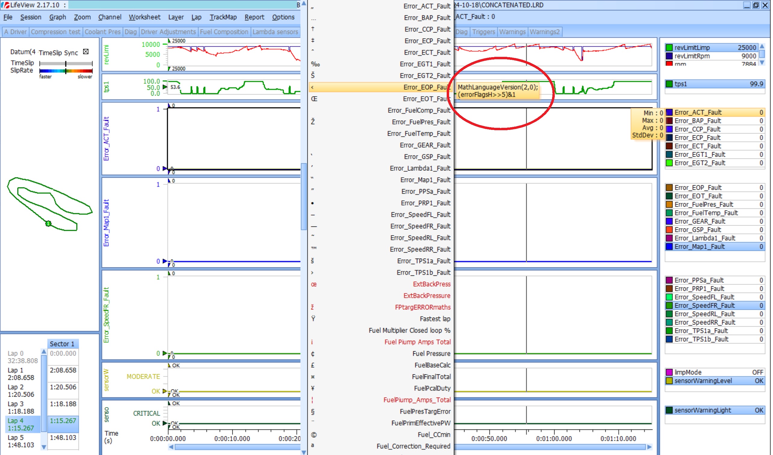

The individual sensor errors can be extracted from “errorFlagsL” and “errorFlagsH” by using the maths circled in red in the screen shot below.
For the EOP sensor fault example shown the “5” in the maths refers to the 5th bit in “errorFlagsH” which in the “Error Flags Items Bit Assignments” in the ECU calibration is assigned as EOP.
Note that “errorFlagsL” refers to Bits 0 to 15 in “Error Flags Items Bit Assignments” and that the 1st bit is “0” and the 16th bit is “15”.
And for “errorFlagsH” refers to Bits 16 to 31 in “Error Flags Items Bit Assignments” and that the 1st bit is bit 16 and the 16th bit is bit 31.
Once the maths is set up it is a great way to instantly spot any sensor problems in the logging.
