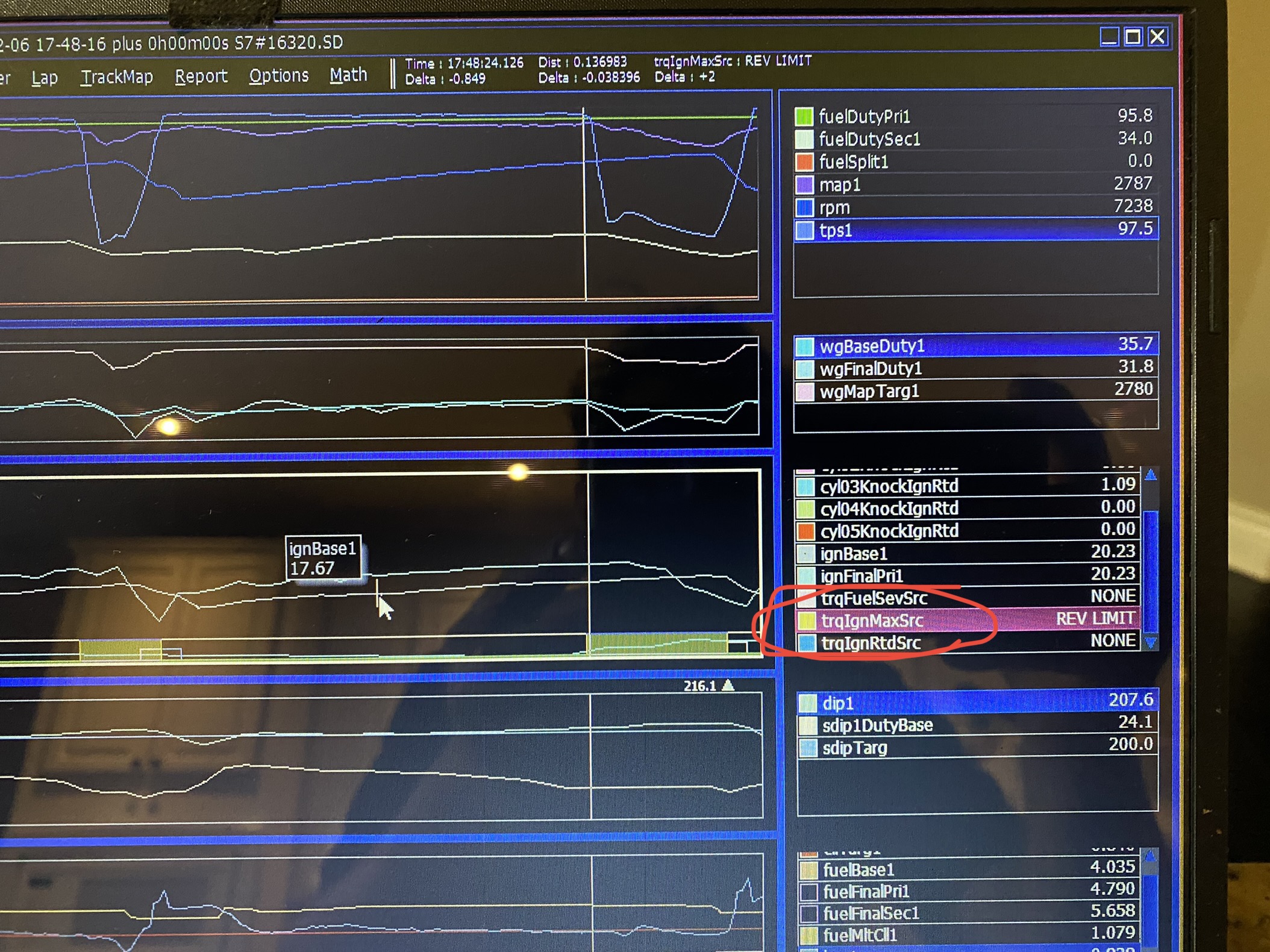

Im coming across a limiter and can seem to find where is coming from is trqIgnMaxSrc which closes the throttle, it says RevLimiter but my limiter is set at 7700 and this limiter becomes active at 7200 any ideas

Check your settings under Limiters -> Rev Limit -> Drive By Wire Closing
