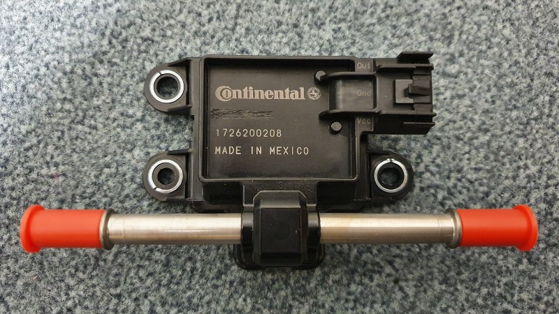

Hi All,
Looking for anyone who's got experience with the Continental type flex fuel sensors and how to spot potential fakes.
I've just received one, from what I considered to be a low risk vendor, and it arrived with a silver sticker designated SE1002S on. It wasn't adhered particularly well so curiosity got the better of me and I lifted it to reveal that, for some reason, the part number has deliberately been ground off :?
Serial batch number is 1726200208
Any opinions welcomed :D

pictures ?
Is it branded Continental ? Any QR type codes etc on it ?

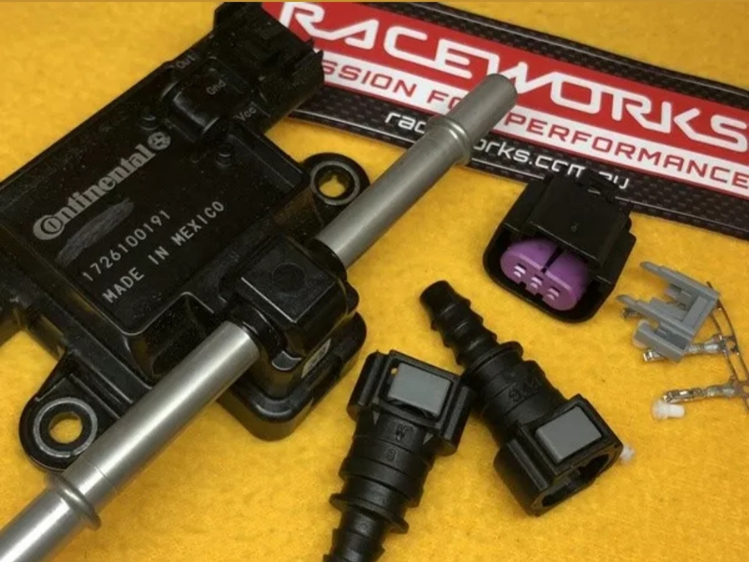

I bought one from the US a while back, and the price did seem cheaper than average although it was part of a kit. But quality etc of the piece lead me to believe it is genuine.
Havent got around to using it though.

Yes branded Continental as per the picture. There's is a QR code on the side which is just a number '60227872'.

Pretty sure mine had the code laser etched into it.
I'm sure I did take photos....damned if I know where they are now.
Mine was a different design of sensor.
Although quality of the item in your picture looks to be good ? Plastic casting, markings etc
I opted for this, rather than cocking about with multiple fittings and tee's or Y pieces for a high flowing setup. Probably overkill.

Some sellers just erase part numbers either so people wont google and buy elsewhere, or they may claim it's something different than others are selling.
Re: Fake flex fuel sensor
When the fitting of after-market flex fuel sensors was unheard of, the first few suppliers bought the Continental sensor, ground numbers off, then stuck a label over it to pass it off as their own.
These days, the parts are well known, but someone somewhere obviously still thinks they are still to be kept secret :roll:
Stevie - interesting one. The sensors have a 3/8" hard pipe, and take -6 fittings. Above a certain power (don't ask me what the threshold is) it does not flow enough so needs a bypass. That PHR item solves the problem neatly and easily - and not a silly stupid price. Not come across it before :geek:
Posts: 1422
Yea, it was the only one I seen I was happy to buy, the other options with lots of fittings were always messy.
But also yea....even a -6 can flow for over 1k, so not sure what level a bypass is actually needed.
In my case although I run a lot of pump, I'm PWM'ing the pumps so actual flow both in, and obviously out the return would be far less than if running the pumps flat out all the time
But the PHR part was cool, not too expensive..so do it right first time.

Thanks for the response Tim. Everything about the sensor looks legit, it just struck me as odd that the part number was ground off.
