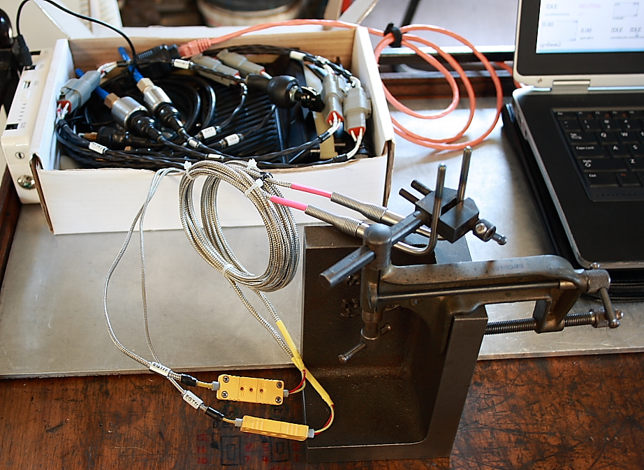

Made a video showing my own development on EGT sensors, have run these things for a long time (mid 1990's) and tested a bit back in the 'dark ages' revisiting some of the very old log files showed up some interesting information.
I found there is much scope for improvement with regards to the following
  • Accuracy
  • Response
  • Durability
In the pure EGT probes available (not fine wire) there is over a 200deg C variance I have personally measured, this has a large impact on TIT. Many times taking off a turbine housing to see the blades in distress its now obvious that the reported temperature is simply that of the probe and not of the gas it is sampling. Over the last few months dealing with the reputable names in TC industry it was often stated to me that "we sell these to companies with test cells who supply race power trains (engines and electronics) and no one questions the readings" these are people who supply DPI, WEC, F1, WRC, level competitors.

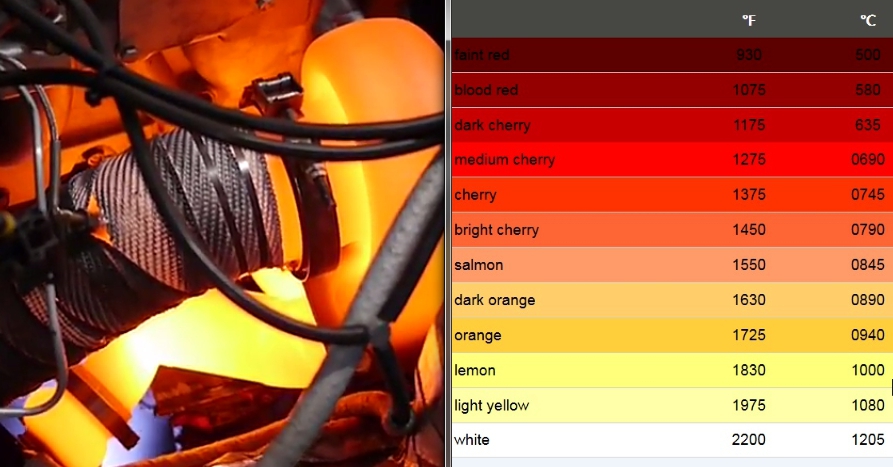

So from the colour chart...is the fast one reading high ?

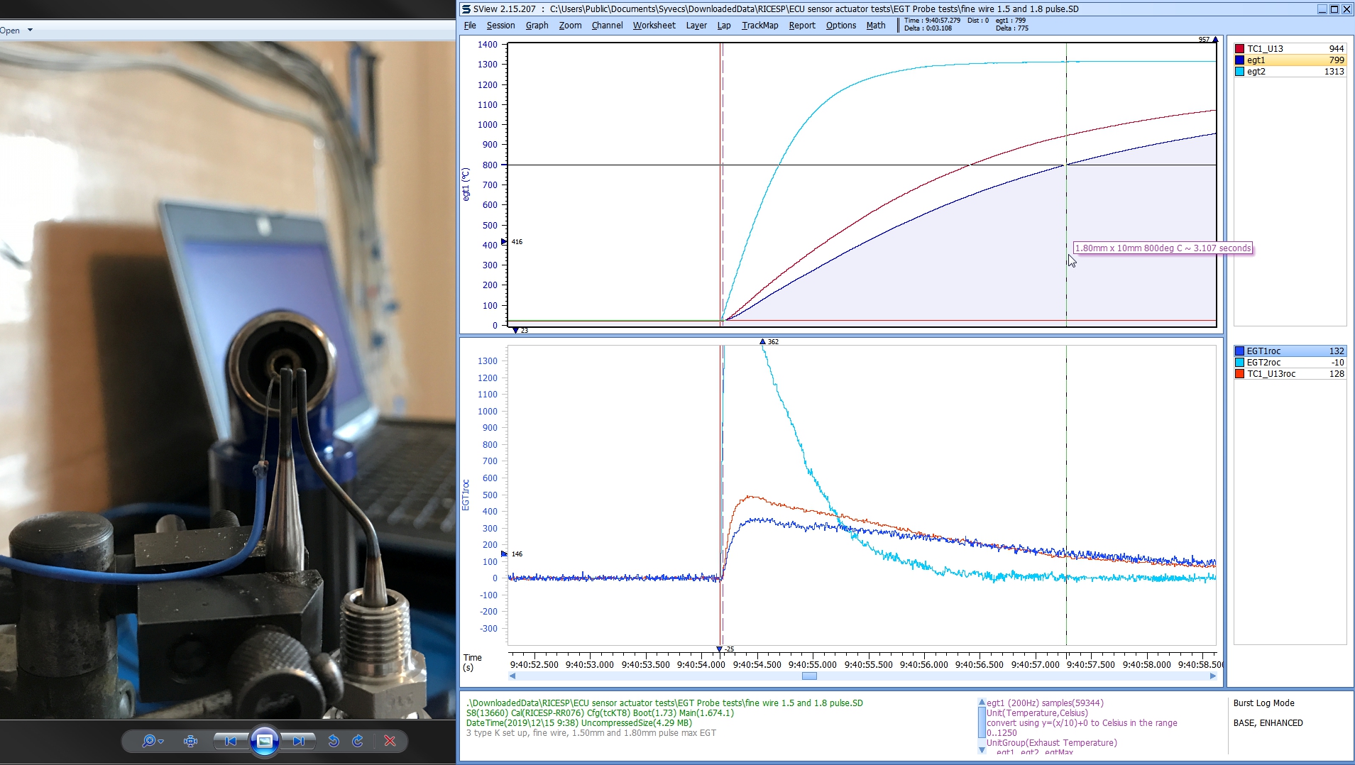

I try, the highest reading one is the thinnest wire type, the names of the channels and temps are at the 4:05 mark in the video for reference.
got a couple of customers sending me their prior spec (new) probes back and I will just fix them up in jig and change out egt1, position the 1.50mm x 30mm and the fine wire right next to it and run the test again to show in real time what the differences are. Its shocking to see how under reported the miss designed EGT probes can be. Nice theory, but in reality they just don't work :)
For calibration that is a good question, the maker of the gas set up I use says the peak flame temperature on butane and air is 1350deg C, the highest I have recorded on fine wire type K is 1345deg C (it does vary depending on ambient pressure, and assuming fully charge gas pressure). To give you an idea of probe variation, some in 1/4" open element will not read above 950 deg C @ ROC = 0......... that is a 400deg C offset !

Through my own research on this I did find some published papers which describe the effect of where the voltage is generated in the TC, and its not at the tip/junction rather a way down further from the saturated point (which by color indicates the same temp give or take). In short without boring people too much at/near the measurement zone (from my own work) its the thermal mass of the probe, the wire used to make it, the insulation, and other factors I wont go into that dictate the accuracy once the probe is saturated (ROC = 0).
The size's, materials, and manufacturing details I finally selected were tested to strike the best balance of durability, response, and accuracy.
How to use an EGT probe is a whole other topic :) can they be fast? you bet! just need one design right ;)
