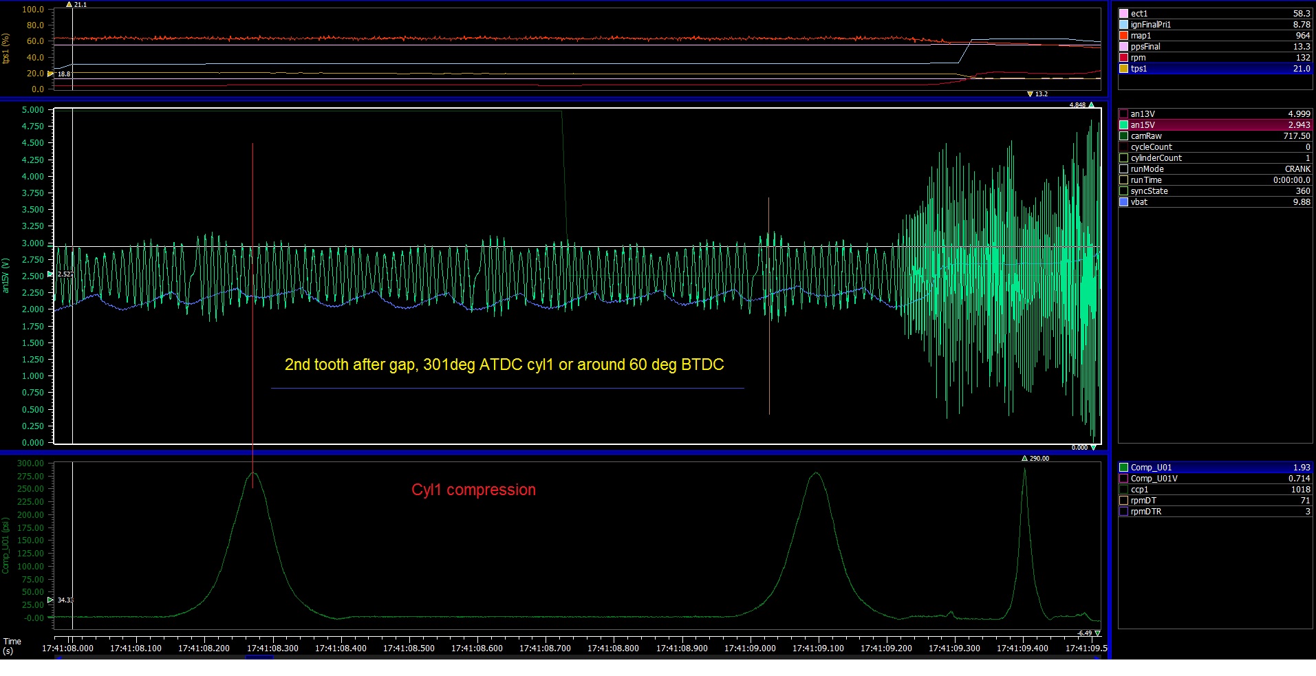

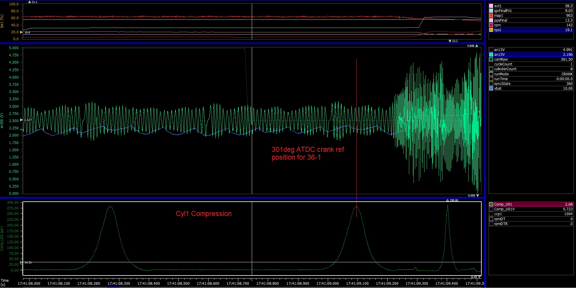

This is mine for a visual reference, 36-1, with the DTA this had a tooth ref of 67 deg BTDC for the first full tooth after the gap.
Same setup on my Syvecs I have it around 301.5degATDC, using the second tooth after the gap as the reference.
As graph shows, cyl1 compression is on the bottom graph to show you where TDC occurs, relative to tooth count. If we could overlay a 720 graph on View...would could examine the various events much easier. But we cant lol ( and I've asked )

Re: 36-1 Trigger wheel fitting
edit, notations on my first pic pic probably didnt make so much sense, so have amended it here
