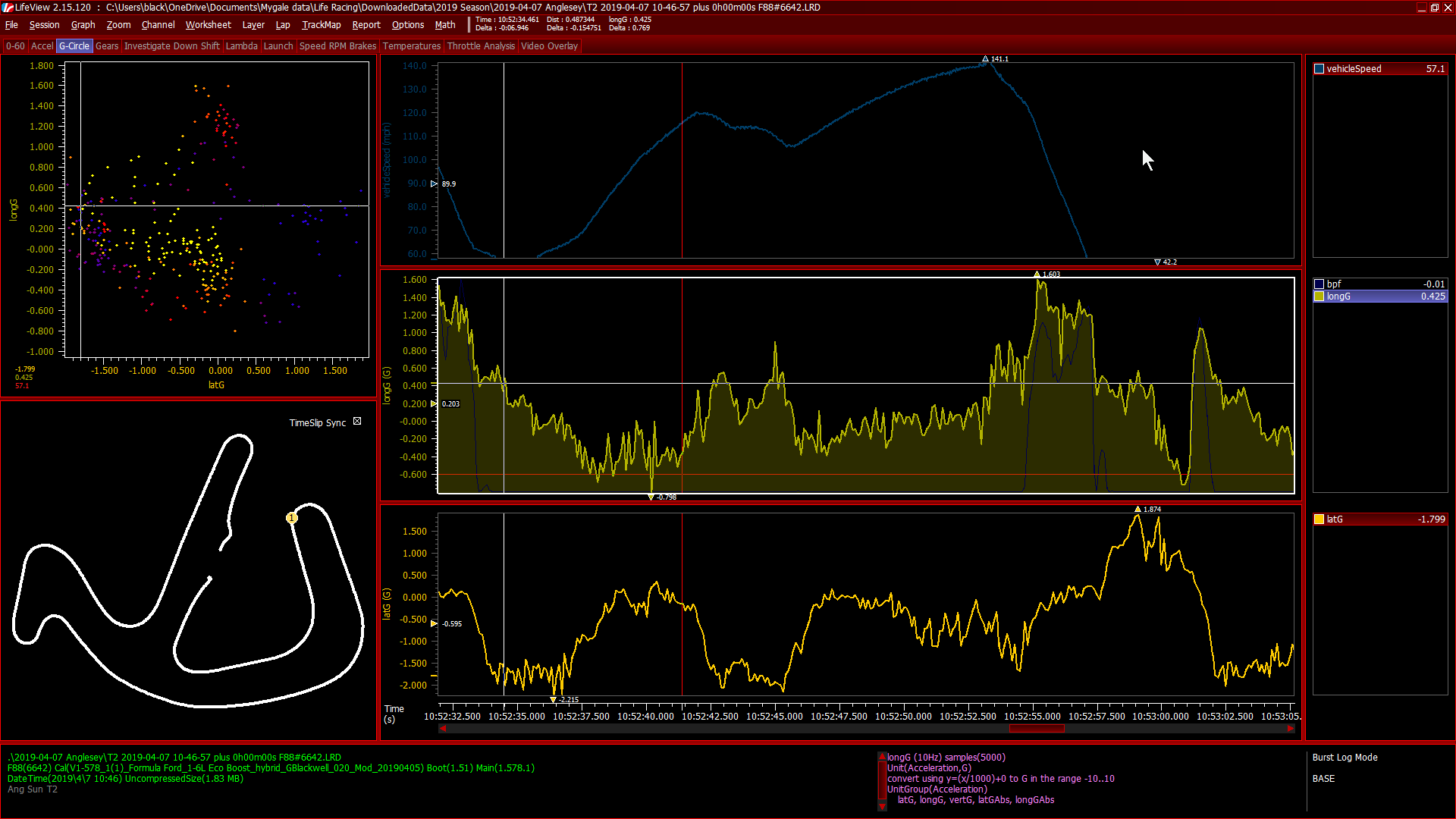

Is this normal, for the G force to jump around as much as this?
Or can the data be smoothed?
I'm using the 10Hz GPS module
Noisy Lat and Long G data
- noisey g force.png (118.18 KiB) Viewed 19130 times

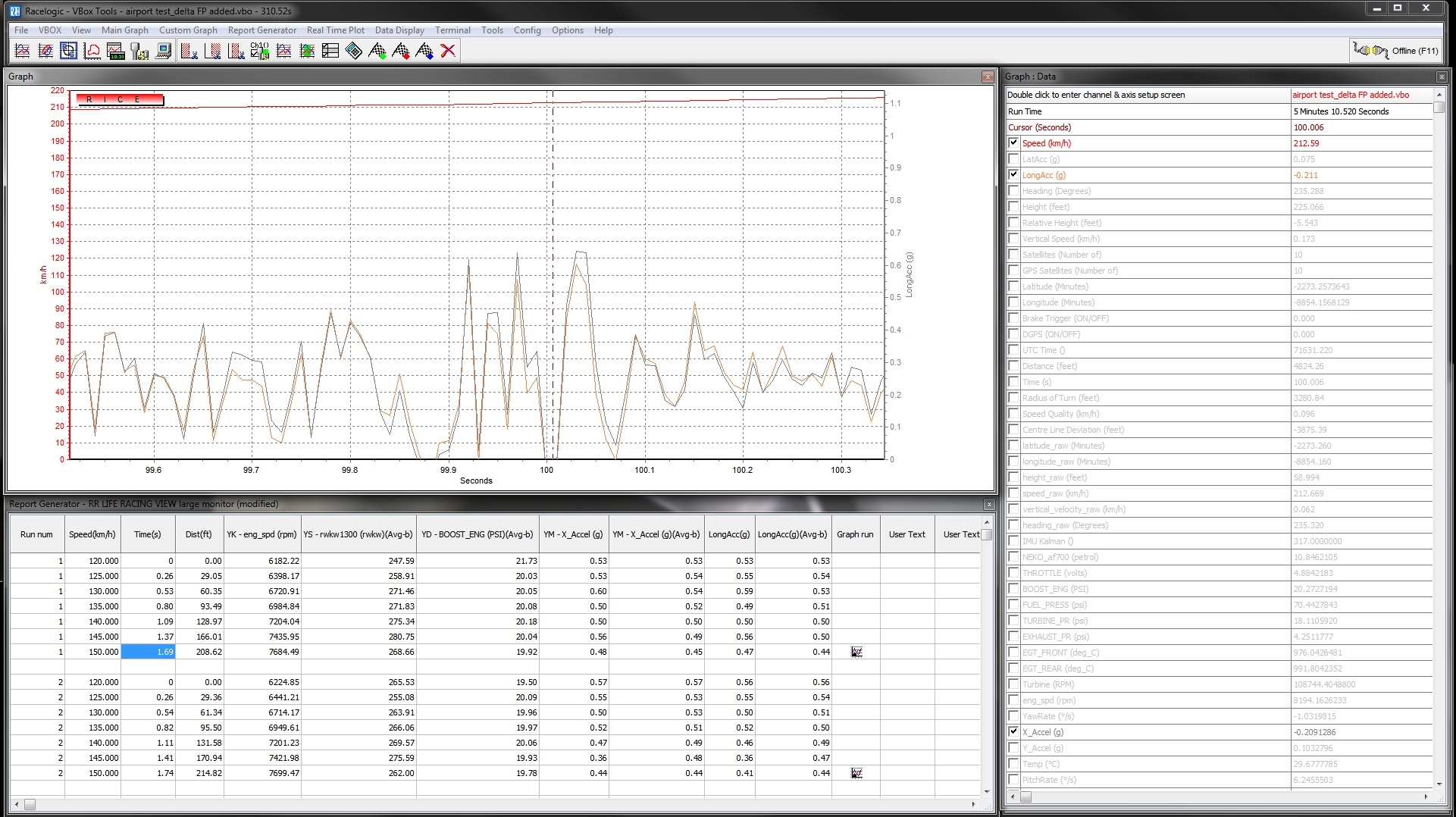

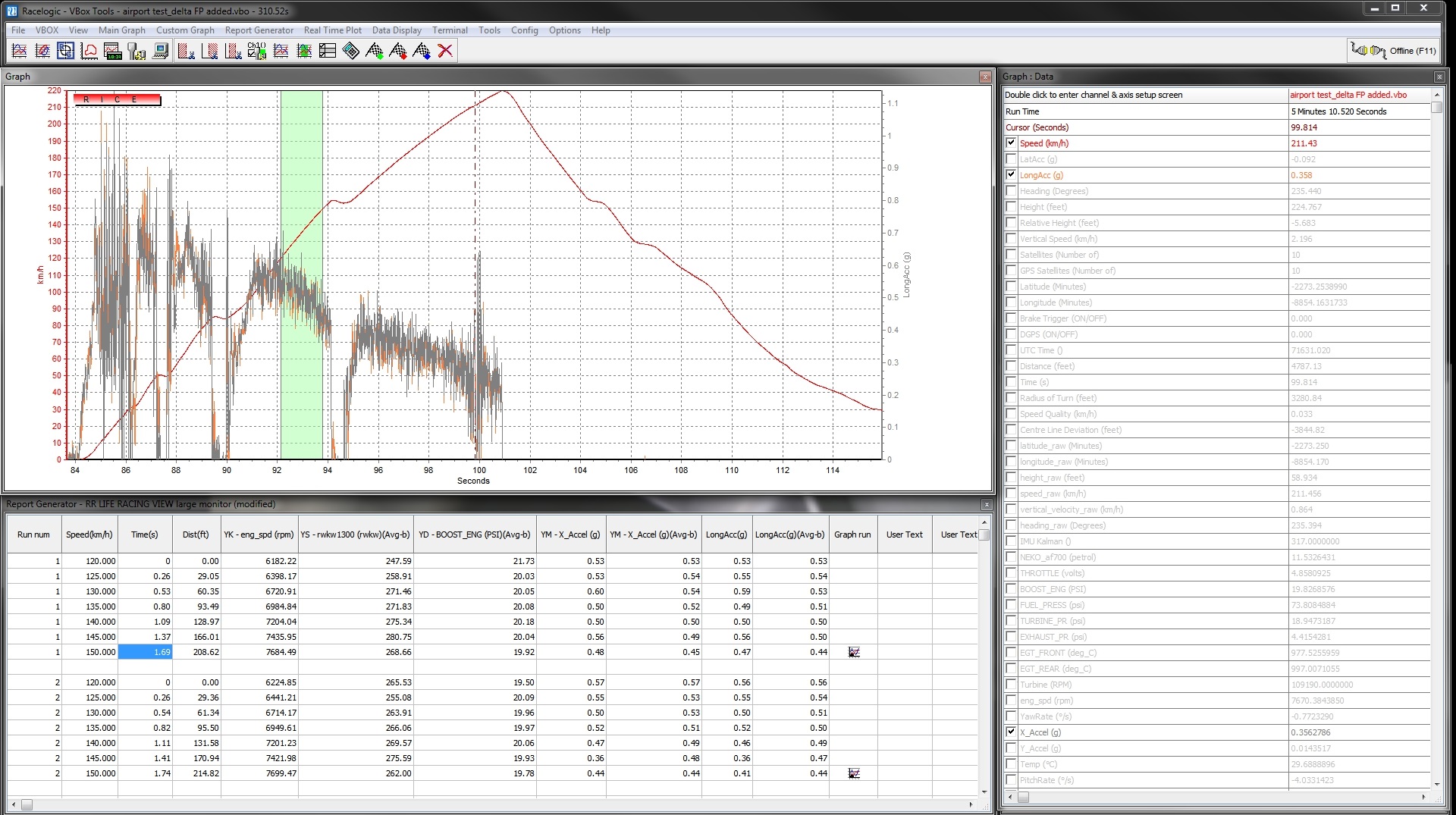

Re: Noisy Lat and Long G data

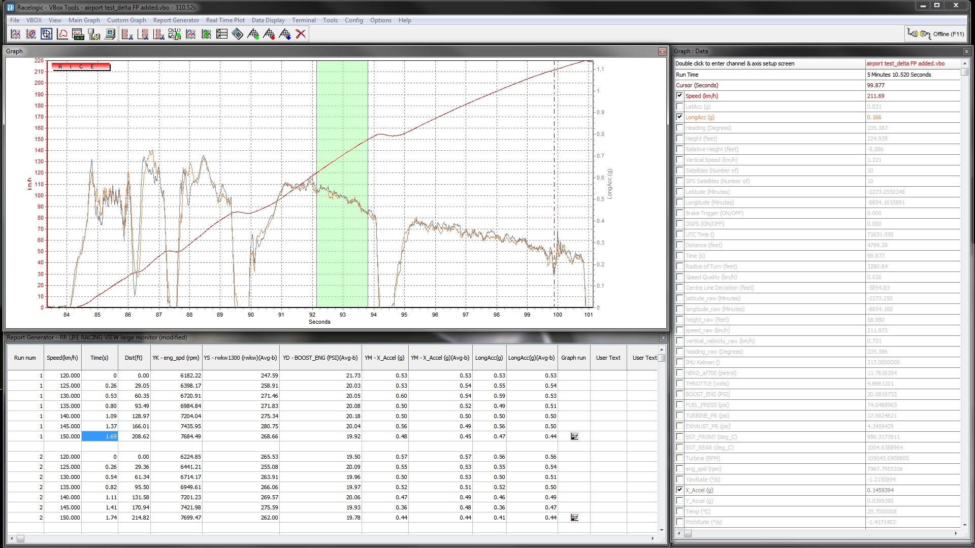

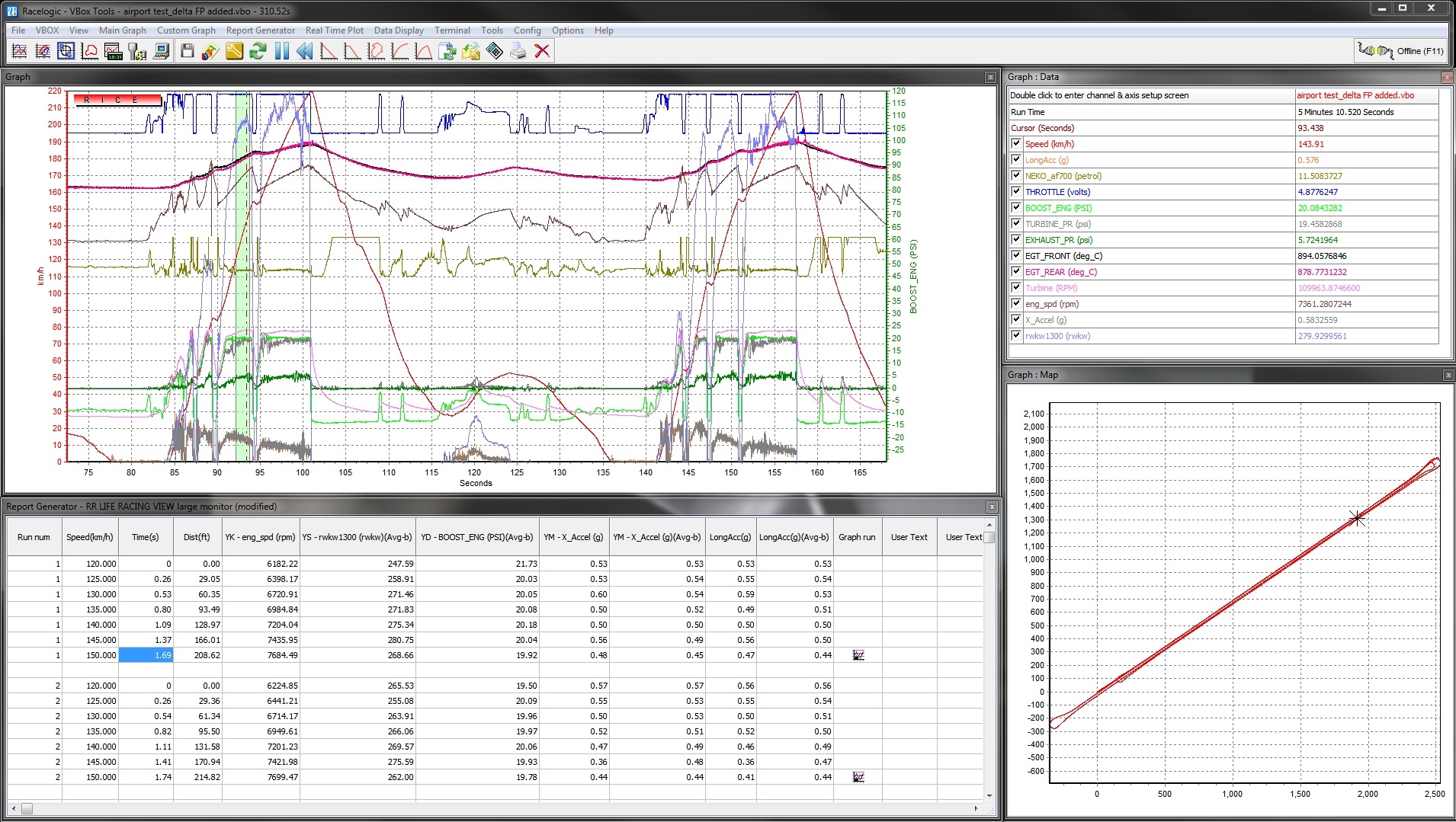

Here is the pictures to show what I mean,
air born at top of 4th gear (bump in run way), both correlate (derived accel from velocity changes) and IMU accel sensor, only shown long g to keep it simple, as same effects happen in other axis.
Also did a report for you showing averages between 5kph intervals as well as on the speed line (non filtered value).
- yo3.jpg (608.96 KiB) Viewed 19103 times
- yo2.jpg (726.12 KiB) Viewed 19103 times
- yo.jpg (736.96 KiB) Viewed 19103 times

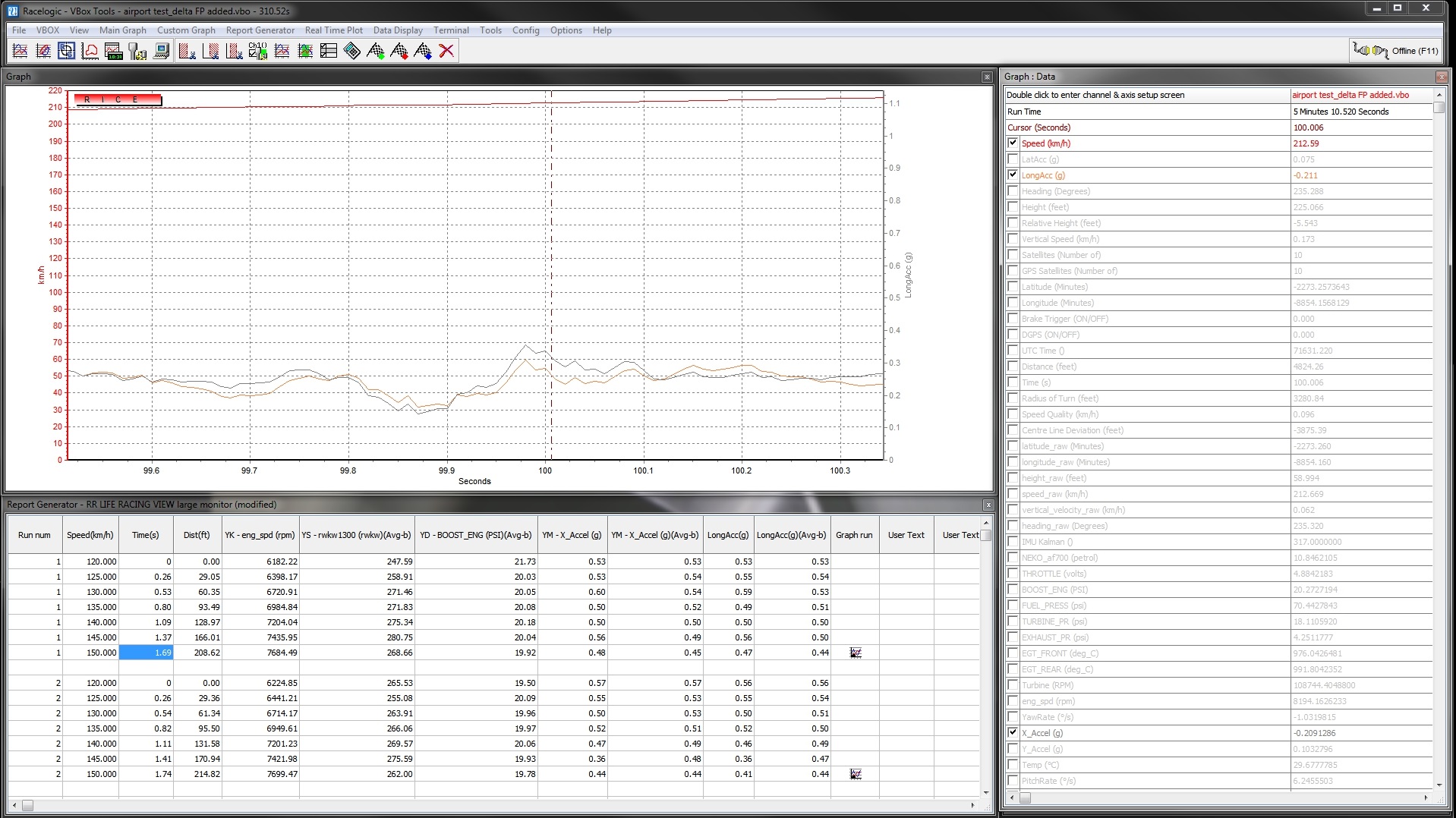

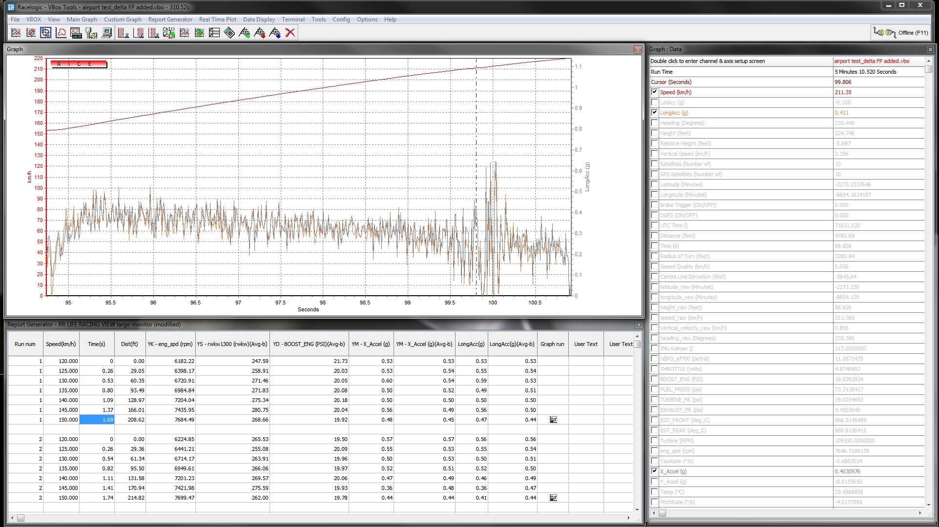

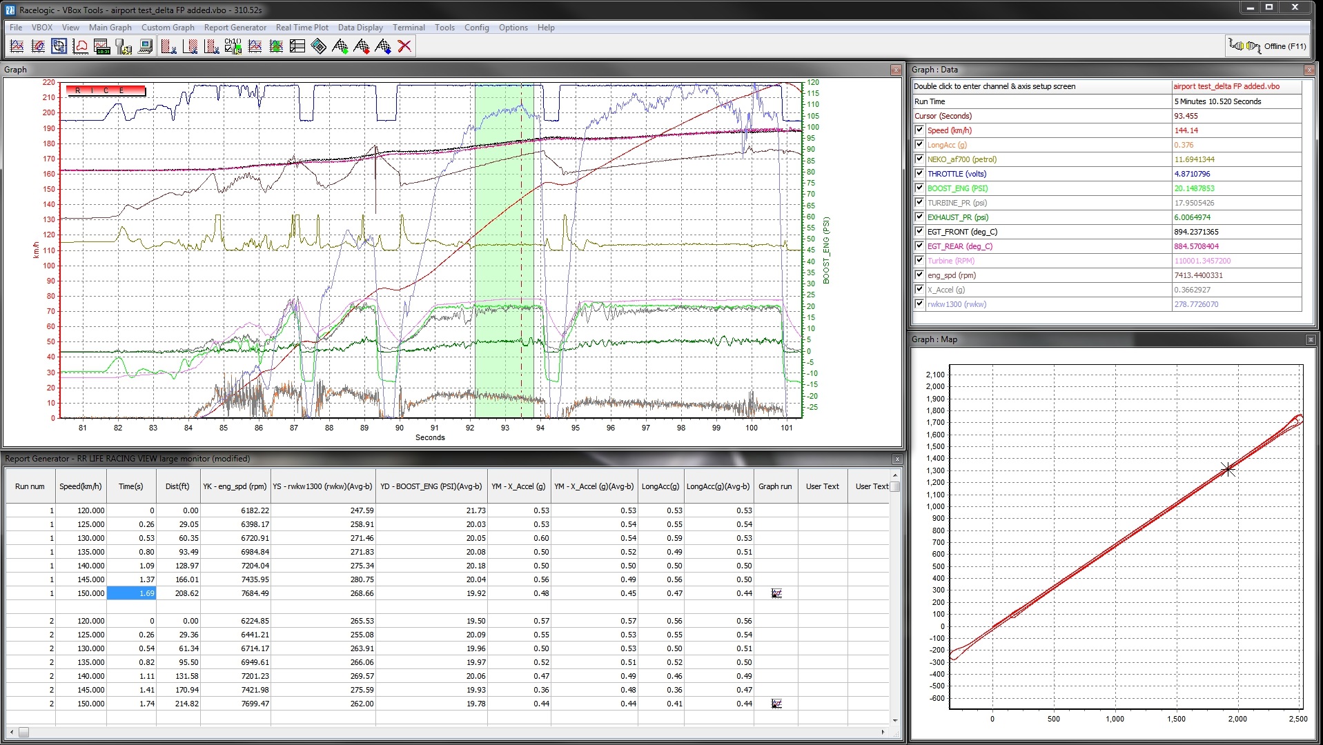

more
- yo4.jpg (607.82 KiB) Viewed 19103 times
- yo6.jpg (567.06 KiB) Viewed 19103 times
- yo5.jpg (587.24 KiB) Viewed 19103 times
Yes, very useful thanks. My GPS module is cable tied to the chassis directly above the front dampers, I hadn't realised that bumps of course have an effect. I wonder if I could mount it on something more compliant.
In the example I gave fyi, the 100Hz GPS (derived accel data) antenna on roof, the IMU (100Hz accel data) in center of car, velcro/dual lock type fixing.Grabla66 wrote: Mon Apr 29, 2019 11:34 am Yes, very useful thanks. My GPS module is cable tied to the chassis directly above the front dampers, I hadn't realised that bumps of course have an effect. I wonder if I could mount it on something more compliant.
You don't really want the IMU dampened as such cause its reflecting everything that is happening to the chassis (bumps included).
Can use the filter in software or a maths channel to clean it up as you see fit, just keep in mind on 100Hz you will loose the instant detail of things like trq reductions for example on traction control tuning.
