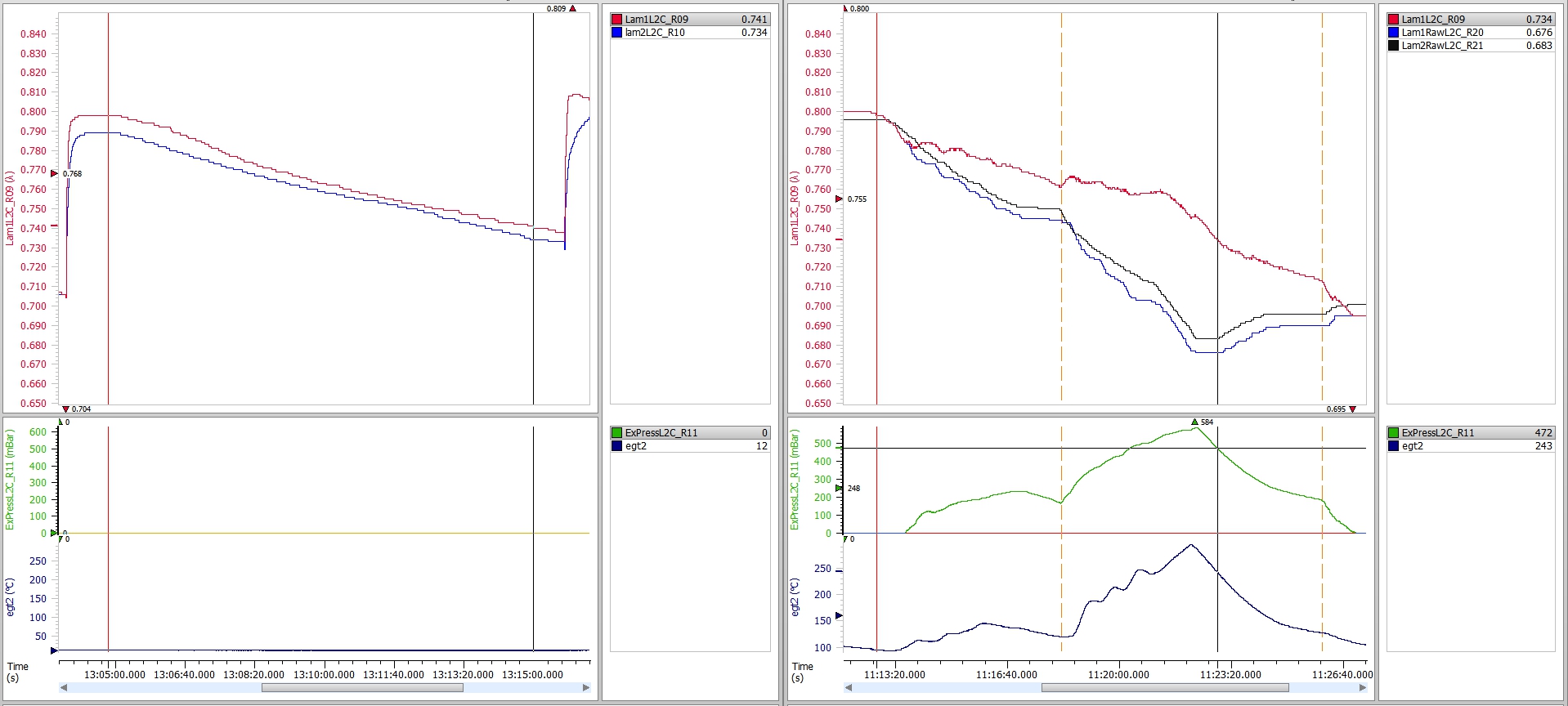

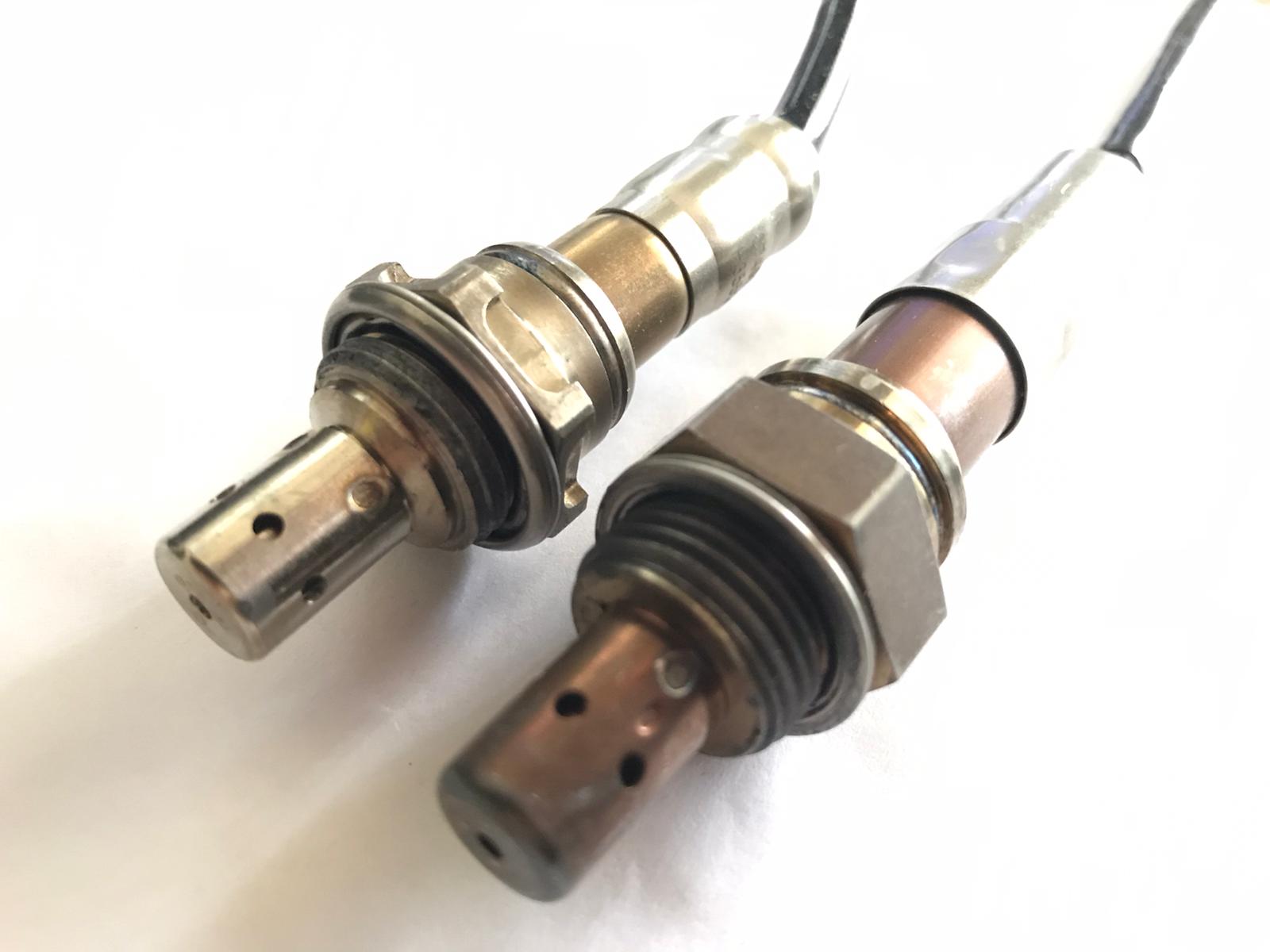

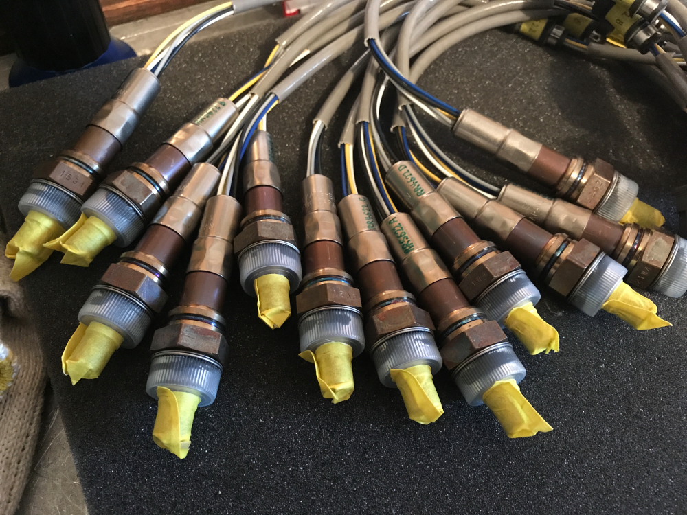

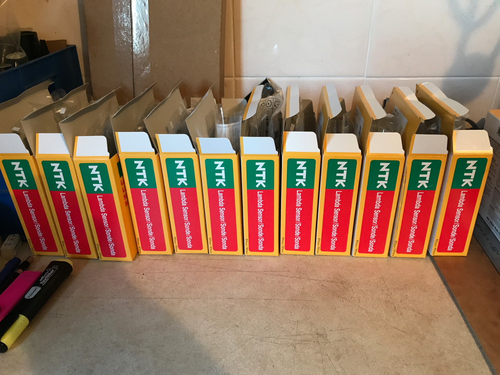

Another batch of these just done, even tested a dyno supplied 'lab grade' equivalent.
The most interesting though is the batch to batch variations! (LZA09-E1) for the new players out there this is identified on the box sticker and wrapping label, this is stamped into one of the flats on the hex nut at the base of the sensor too! Even if I was not offering these I would still be suggesting people strongly to NOT trust an out of the box sensor with generic calibration, cause even if the batch number is the same you still see a variance though not as large....... its cheap at end of the day using a sensor that has been certified to be accurate and precise.

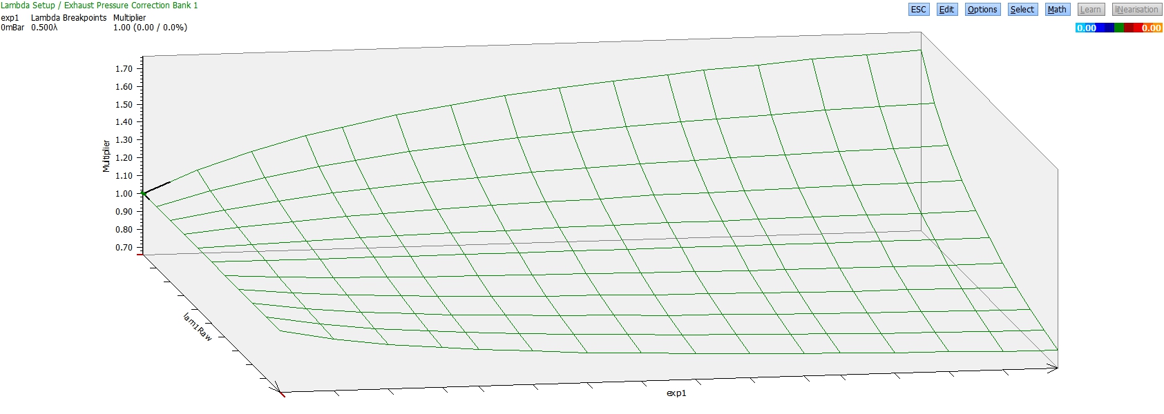

Does 8 8-)
and *yes* any side 8-) as below this is common TEP (turbine exit pressure) values and effects, not simulated but in real life 8-) multiple different days/weeks/sensors 40+ hours log time/testing/developing/proving........... 8-)
ex press corrected 2.jpg (335.5 KiB) Viewed 152275 times
ex press corrected 1.jpg (597.31 KiB) Viewed 152275 times
tep corrected proof.jpg (399.99 KiB) Viewed 152273 times
Posts: 537
something that may get people aroused is the fact of turbine exit pressure and just how large an effect this can and does have, say on a ~2000bhp methanol drag racing application (I've been running them on everything since 2008 or so, but a more extreme rich running example will get the juices flowing!). Will have a car running TEP sensor and happy to put up some info here to share since its often overlooked, well not openly discussed at minimum.

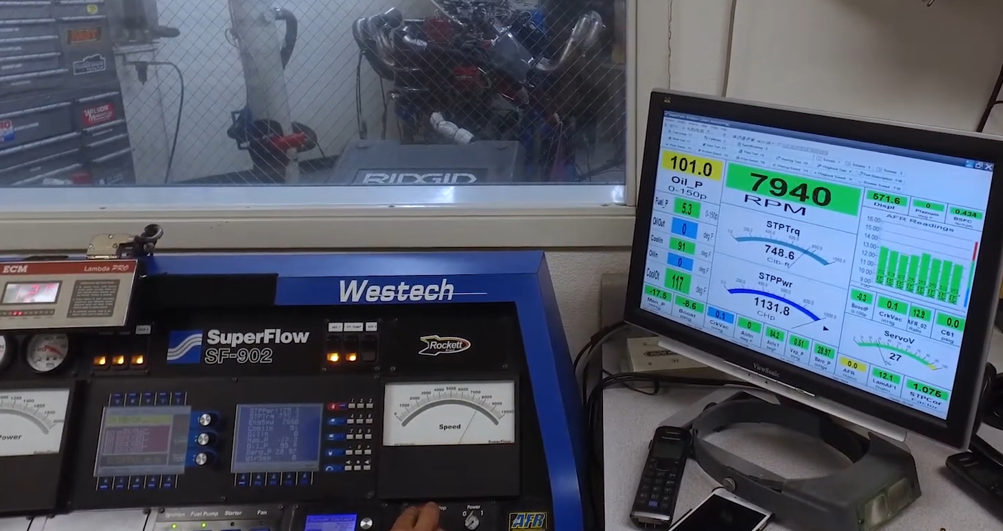

Here is an example of O2 readings done poorly, pick a number any number
https://youtu.be/qzLY0iA4050
  • ECM Lambda PRO 'claimed' professional unit reference 12.5:1 AFR
  • ECM Lambda PRO output to dyno 12.1:1 AFR
  • unknown brand 8 cylinders listed AFR average of 13.0:1
pick a number cunts.jpg (594.38 KiB) Viewed 151972 times
