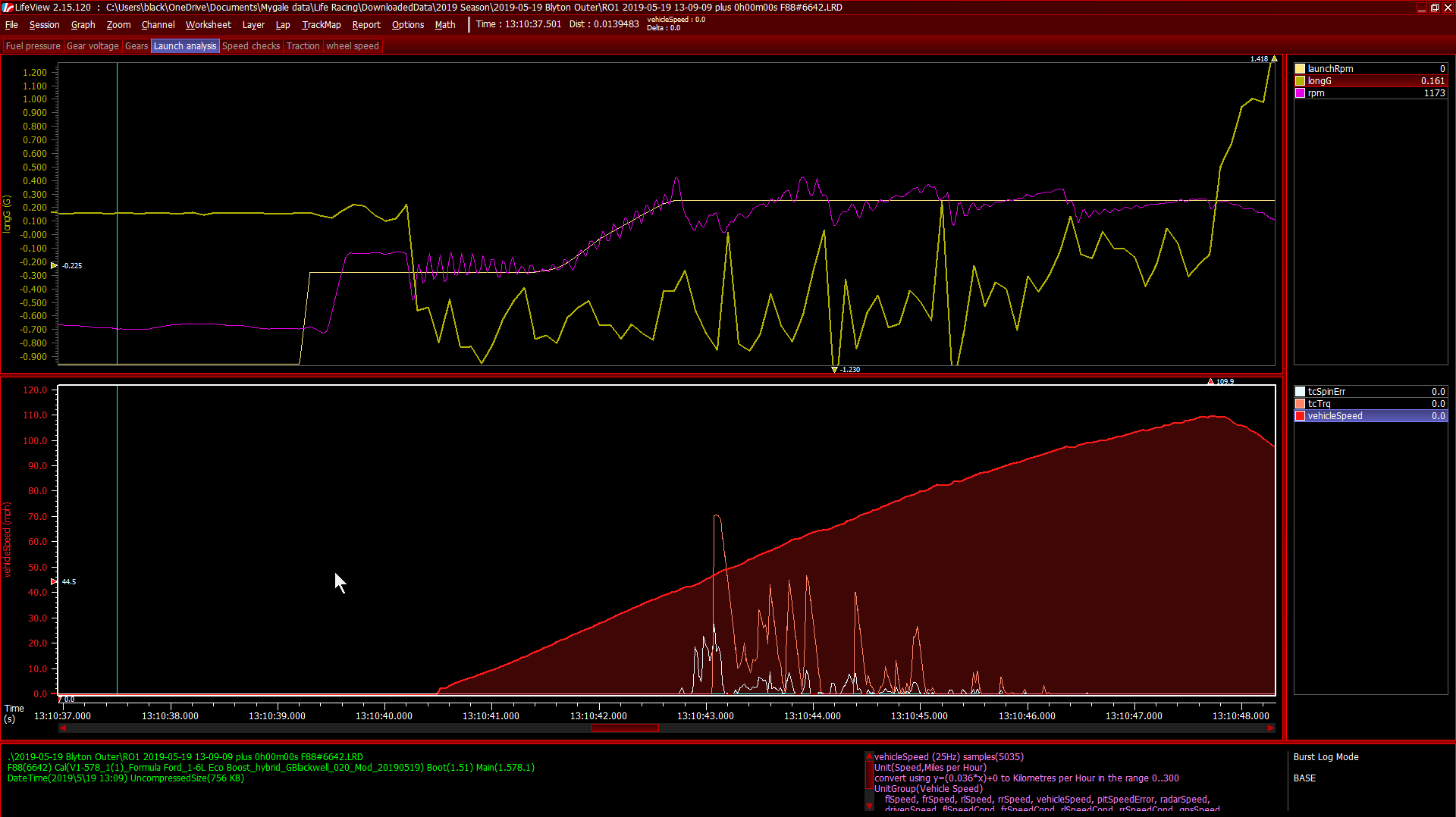

Panic over.
I've now looked at the data from the last pair of runs on Sunday, and before I went out, I'd raised the upper base engine rpm from 6050 to 6500 at the highest speed breakpoint of 45mph. (It was previously set to 6050rpm which equals 40.5mph in 1st gear so it couldnt have reached 45mph at those revs)
The data from the last two runs shows that the engine rpm was allowed to rise above 6000rpm during launch, the automatic gearshift occurred at 6000rpm, and PIT/LAUNCH events stopped a fraction over 40mph, so it was all working properly.
Q) What key do I need to press to get the data to appear inset in the graphs, like it shows on Ryans's Syvecs training videos? (see attachment)

Options, All Toggle Options, Show items in graph.
Re: Launch Control Settings
Thanks I'd never have found that.

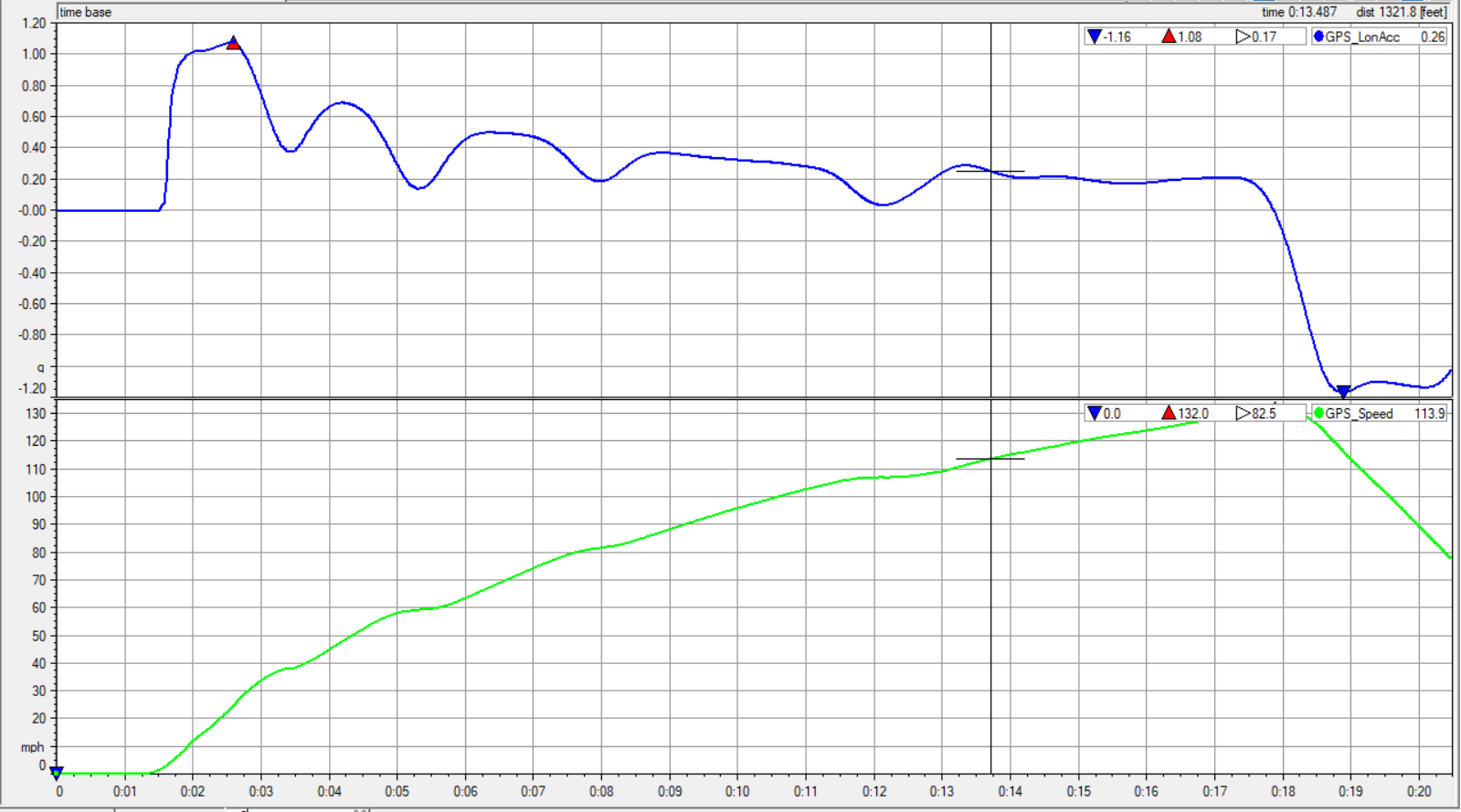

The trace below is from my AIM Solo GPS logging doing a standing 1/4 mile on average grip tarmac and then straight into a flying 250 metres. The most I've seen is 1.19G on a fairly rough tarmac surface. I've not launched the car on a high grip surface, but limit is my clutch anyway.
