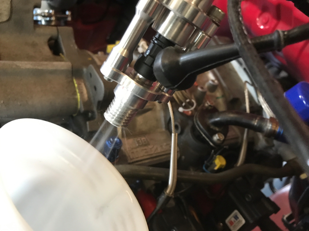

Learned allot, especially for people wanting to apply this in a synchronous manner (port injection), There is no doubt many who don't use the Internet/Arsebook for knowledge so for the other bottom feeders who do will put it up here
More water / meth injection
Tested to 2000Hz PWM Frequency on Aquatec pump, no issue for the Life Racing PDUx3
~ 3 hours run time on pump, that is allot of 1/4 mile passes
BIG issues using this pump as delivered for that application just on its own and this is compounded when using a HSV or solenoid flow control device upstream !
Love this, proper control

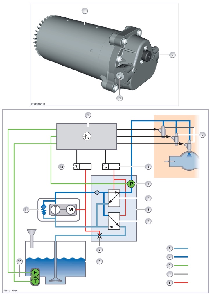

Just had another dig through to see, looks remarkably similar to the AEM style pump we all know;
Water pump
The known engine S55B30T0 is used. The power could be increased to 368 kW/500 hp using water injection and the torque could be increased to 600 Nm.
Since distilled water also contains bound oxygen and leads to cooling of the combustion chamber, the filling can thus be increased above the charging pressure in the cylinder by using distilled water. Accordingly, more power can be generated in the combustion engine.
Functional description
The medium of distilled water (subsequently called "water") is carried along in a separate washer fluid reservoir in the vehicle. For a certain operating point (e.g. charging pressure, load, engine speed), the water is drawn in and compressed to 10 bar through a coolant pump. The drawn in water is moved to 3 water injection valves through a line. The water is finely atomized and injected and supplied via the funnels to the combustion chamber with the help of the water injection valves, which are installed in the intake plenum for the intake air.
Item Explanation Item Explanation
1 Water pump 2 Connection to water line
3 Connection to water line
The water pump is activated by the engine control via water injection relay 2. The coolant pump generates a pressure of approx. 10 bar.
A water pressure sensor on the valve block monitors the pressure generated by the coolant pump.
Structure and inner electrical connection
The coolant pump is connected using a two-pin plug connection.
The water pump is switched on and off via water injection relay 2. The coolant pump has only one direction of movement. For this reason, the backflush valves are necessary in order to empty the water lines.
1 Water pump 2 Interference suppression capacitor
3 Pump motor
Pin assignments
Pin Explanation
U Voltage supply of coolant pump
Kl. 31 Terminal 31, ground
Activation and setpoint values
Please note the following setpoint values for the coolant pump:
Variable Value
Supply voltage 9 to 16 volts
System pressure maximum 10 bar
Temperature range -30 °C to 140 °C
Diagnosis instructions
Failure of the component
If the coolant pump fails, the following behaviour is to be expected:
Water injection not possible
The water injection has diagnostic capability through the Digital Motor Electronics (DME).
General notes
Note!
When the engine is stopped and when the system is drained, operating noises are generated, which can be heard by the customer. These operating noises cannot be avoided for reasons inherent in the system.
I've attached a picture of the pump, and the diagram from the body of text before, if it is of any interest
- BMW Water injection.jpg (112.98 KiB) Viewed 442907 times
- Posts: 1420
It may only be an outline, but sure looks like the common standard DDP5800 pump or a variant of it.

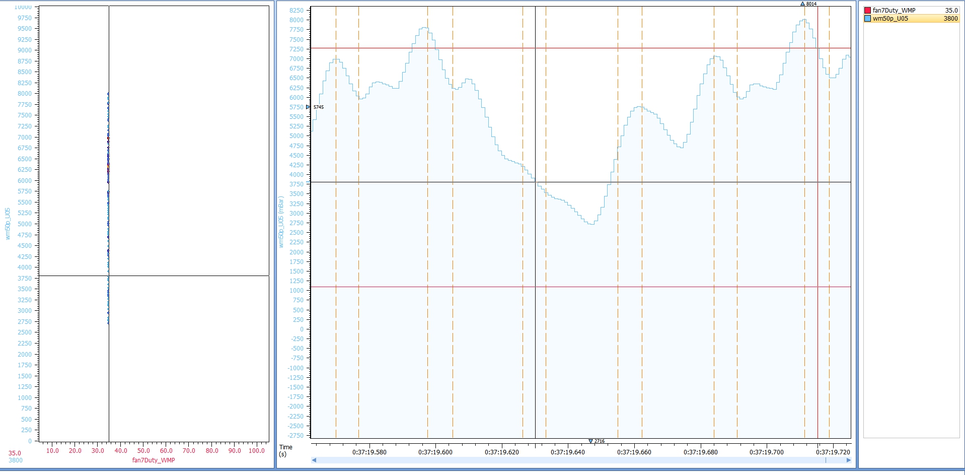

May as well share this for others benefit.
This is showing 6 cycles of an injector combined with the 'toilet water' pump. Center of ~7ms pressure log, you can all see this issue of this clear as day, you have a pump head at (in this example) 85.7Hz, injector at 34.75Hz you have a timing overlay shift dep on run time at fixed operation points where the amount delivered can vary allot! so sometimes the oscillation looks acceptable then other times its not. The 'toilet water' pump head has a three chamber design that the inlet on the left feeds the head and as the wobbler goes around the chamber work in sequence and each one of them has a pressure drop the furthest away is worst repeated every revolution. Pump speed and thus frequency of this pressure drop varies but is worse the higher the base pressure requested. Compound this with PWM speed settings from 300rpm to 2100rpm (open flow) or around 1700rpm at high pressure and you can start to get an idea of the problem.
Overlay on top the function of the injector (size/flow-number of them) then it gets more complex, very easy to see how kuntz blow shit up on a 'conservative tune' when they have zero idea of how the volume can change cycle to cycle per cylinder, you may think you have X amount of percentage of WM but what actually happens is another matter.

There are pulses with nothing in the system (just the 'toilet water' RV bilge) pump fittedMReilly wrote: Sat May 01, 2021 11:09 am Now that's a money saving part number to know Stevie, thanks for that!

I've had trouble with pulsation in a conventional petrol fuel system when running a dead head system before, there seems to be something good in having the injectors in between the regulator and the pump in smoothing out pulsations, I guess the regulator acts as a sort of damper and dissipates the reflections of the injectors pulsations, maybe it would help with the pumps pulsations too?
Have tried a few things, some work well, keep that to myself though
Sans that type even just the ghetto band X shitbox system using the same 'toilet water' pump run at high pressure will have the same pulsations there, combined with say poor distribution I can easily see it going from safe 'conservative tune' LOL to shit blew up for no apparent reason type deal
