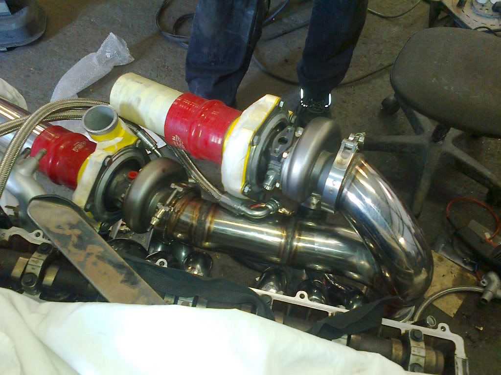

you seem to have missed the entire point of the post. i live on the westernmost tip of wales. it is at least a 4 hour drive to get any tuner here. i have changed my turbos and manifolds which means that every water and oil pipe is a new and untested connection. when i start it up and get it warm i could have a dozen leaks to sort out taking days. what is the engine tuner supposed to do whilst i fix them. i don't need it running down the road but i do need to get it warm to sort out any leaks and see it there are any problems with the dozens of new brakets i have had to make up.
there are loads of things to check long before tuning it as very little is original. it isn't just the computer i have changed. i went mental!

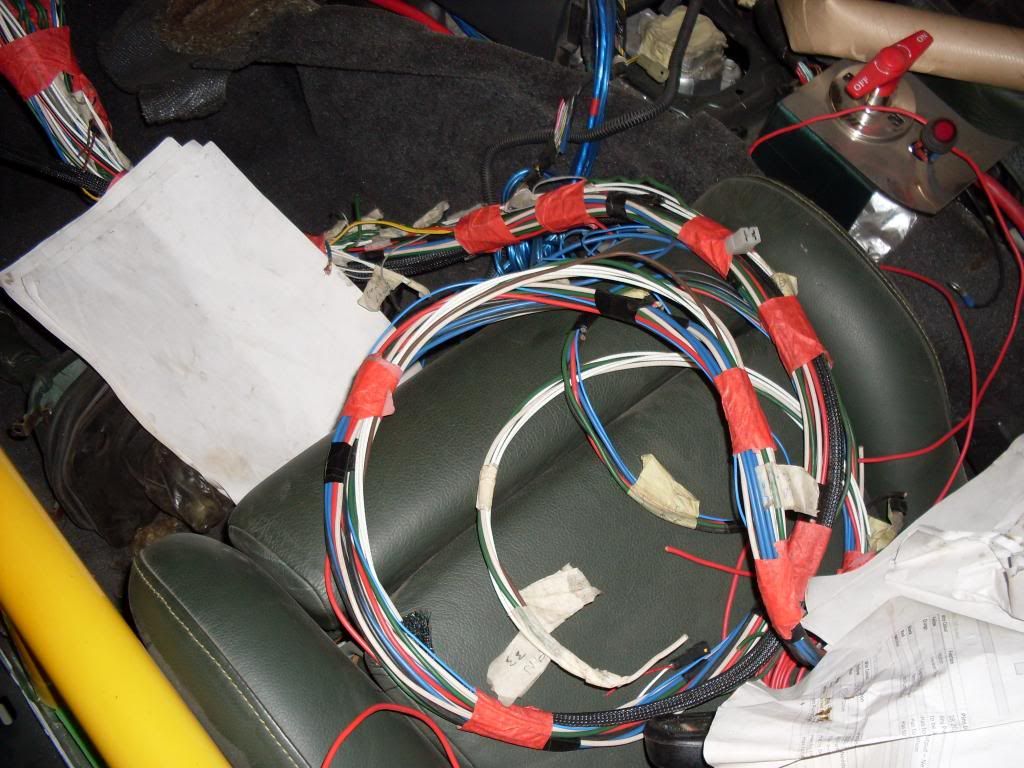

still doing the wiring, bought loads of stuff and am now paying the price by having to wire it all in to the original looms. will get there in the end, one wire at a time.

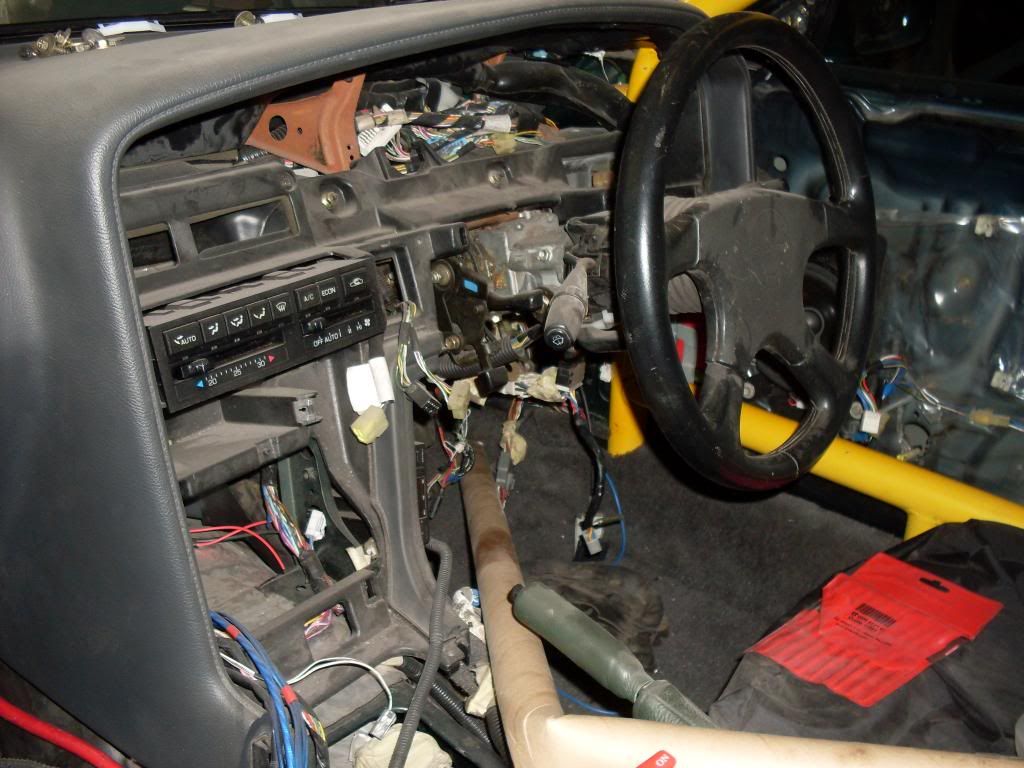

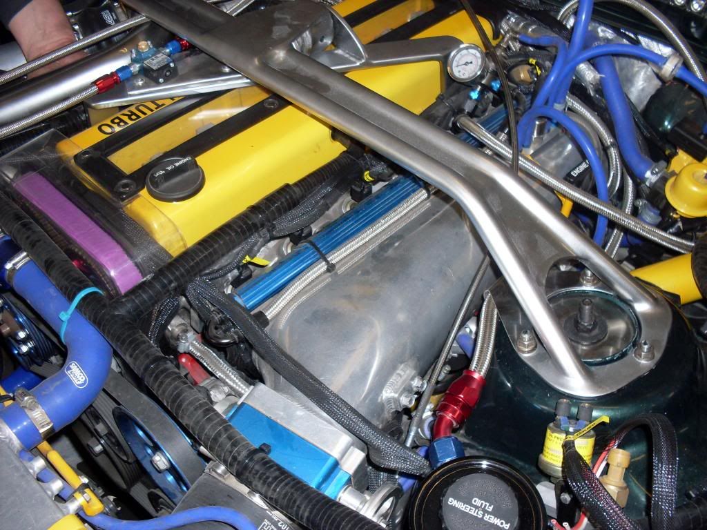

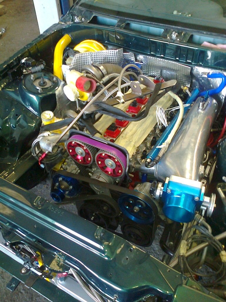

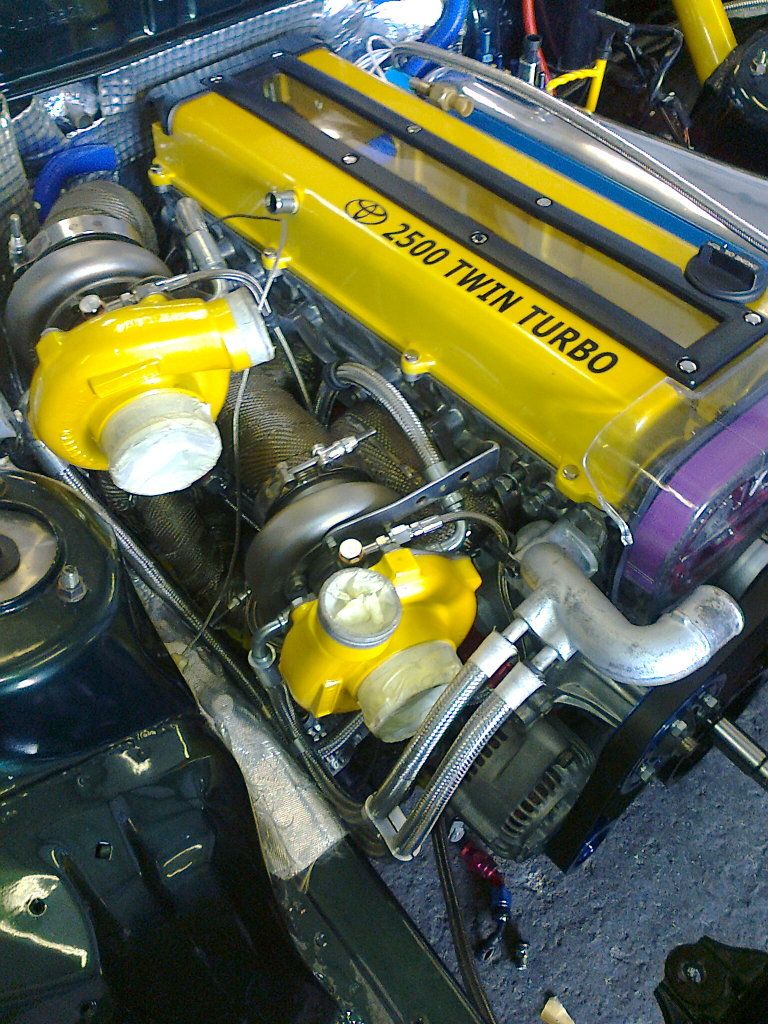

getting there
underbonnet nearly finished but the inside not even started properly yet. engine/computer loom just chillin' out on the passenger seat.
dash needs finishing as well.
