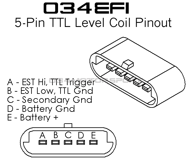

Now I have only coils and camshaft hall-sensors to be connect so couple question from them:
Coils are IGN-1A and here is pinout:
A - Ignition signal from ECU
B - Logic ground, connect to ECU ground
C - Spark wire ground, connect to cylinder head
D - Power ground, connect to battery negative
E - 12 volt power
And some Info:
These coils are designed to put out 103 mJ per spark, with a longer spark duration (2.9 ms) than what you'd see with a capacitive discharge. They can be driven with a 5 volt logic level output - we recommend a 270 to 330 ohm pullup if you're building a MegaSquirt to drive them, and they can fully charge with as low as 2.5 ms of dwell.
The coil charges when a 5 volt signal is applied to pin A, and fires when the voltage drops to zero. The signal is similar to an LSx coil, although it does need a bit more current than what is needed to make an LSx coil charge.
Questions:
1. Pin A => +5vout or ign pins on S6 ?
2. Pin B => Inj or aux (or Ign pins if pin A is +5vout) on S6 ?
3. Is there some other things what should I know about these coils connections ?

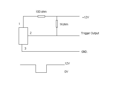

And cam Hall-sensors question:
4. Is trigger active high or low ?

vayne wrote: And some Info:
Questions:
-Mikko-
Pin A => IGN-pins on S6 (ign outputs configured to 5V)
Pin B => ECU ground
This 2,5ms dwell is not really "full charge". It is wery low charge, something under 4A primary current.
Useful Dwell ~4 to 6ms (5ms is very normal).
Primary charge current/Dwell time (RED curve) on the next picture...
http://picasaweb.google.com/jaritlaine/ ... 8387374802
Attachment picture with little different text for coil pins.
- IGN_1A___034_coil.png (19.36 KiB) Viewed 43184 times

- 306 S16 (XU10J4RS) - Camshaft Position sensor (Current Limiting and Pull UP Schematic) - sensor_wiring.jpg (8.26 KiB) Viewed 43183 times

Re: S6 GP wiring to beginner ?
as its got a pull up, its low, which the wave form shows

The S6 can trigger off rising or falling edge, just configure the sensor accordingly. The S6 has software configurable input pullups on inputs capable of measuring speed type signals; it depends on the sensor as to whether you need to turn it on or not. Easy enough to test; trace the AN input that the sensor is on (eg AN05V is it's on AU1), if you see the voltage swinging with the pullup turned off then you don't need it (it may still help though). If you don't see a waveform then try turning the pullup on.... this is done by setting the input type to "Thermistor".4. Is trigger active high or low ?
