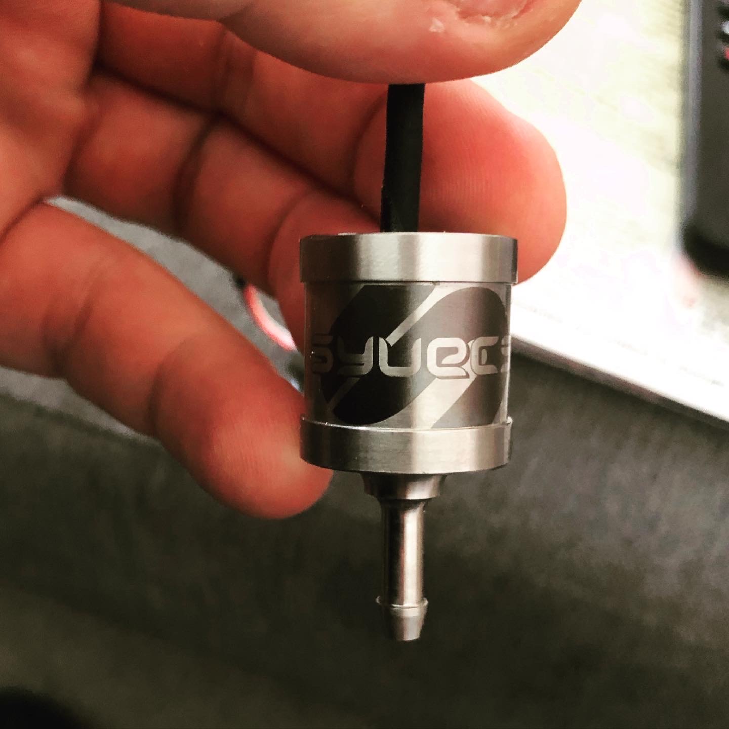

Thanks for that tim, yes it’s been confirmed this is a very old Syvecs map 4bar sensor! Probably why it’s playing up!
I have gone ahead and bought the new 4bar Syvecs map sensor from racecal. It does have a sheet with it!
If you think I shouldn’t need calibration between the old version and the up to date version I’ll go ahead and fit and run!
Otherwise I’ll need someone to calibrate it remotely.
I’ve added a pic of the new version! You can see how different they are compared to my first post picture

I doubt the calibration is the same, but the relavant data is printed on it. If you don't know how to interpret it wait until a mapper can check and tweak the Cal.

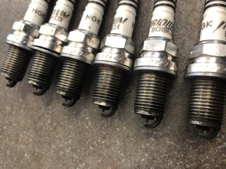

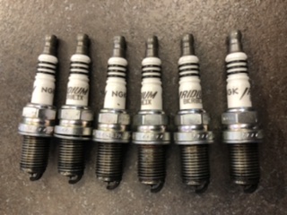

Fitted today and having it calibrated this evening so all good, hopefully she will start again! The plugs were slightly wet and very black so gave them a clean, probably due to the map sensor failing

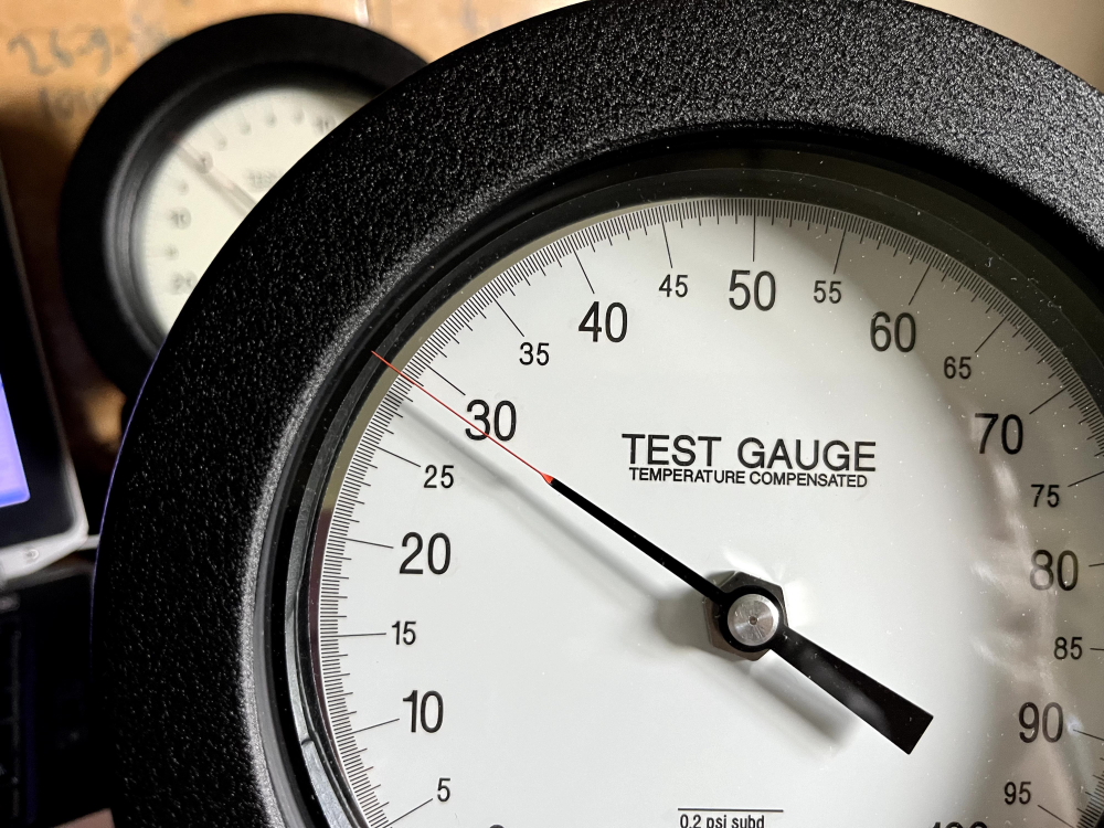

Depends how excited you want to get (like everything in life) but is nice to do your own calibrations of all sensors.
Here is how I do mine and for others if you want perfection
MAP sensors you need to know your exact ambient pressure at the time you calibrate then (easy enough to get) and validate if you have an appropriate reference sensor and do some maths as pictured, or you can guess it as well using tools in your phone if you have nothing else on hand
cal don yo3.JPG (577.5 KiB) Viewed 17401 times
cal don yo2.JPG (533.7 KiB) Viewed 17401 times
cal don yo1.JPG (442.52 KiB) Viewed 17401 times

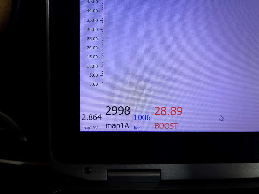

Re: Syvecs map sensor identification
I use a live bap reading sensor input as its is amazing how much it can change in the course of running a test, it is all down to how anal you are, some love anal more than others
