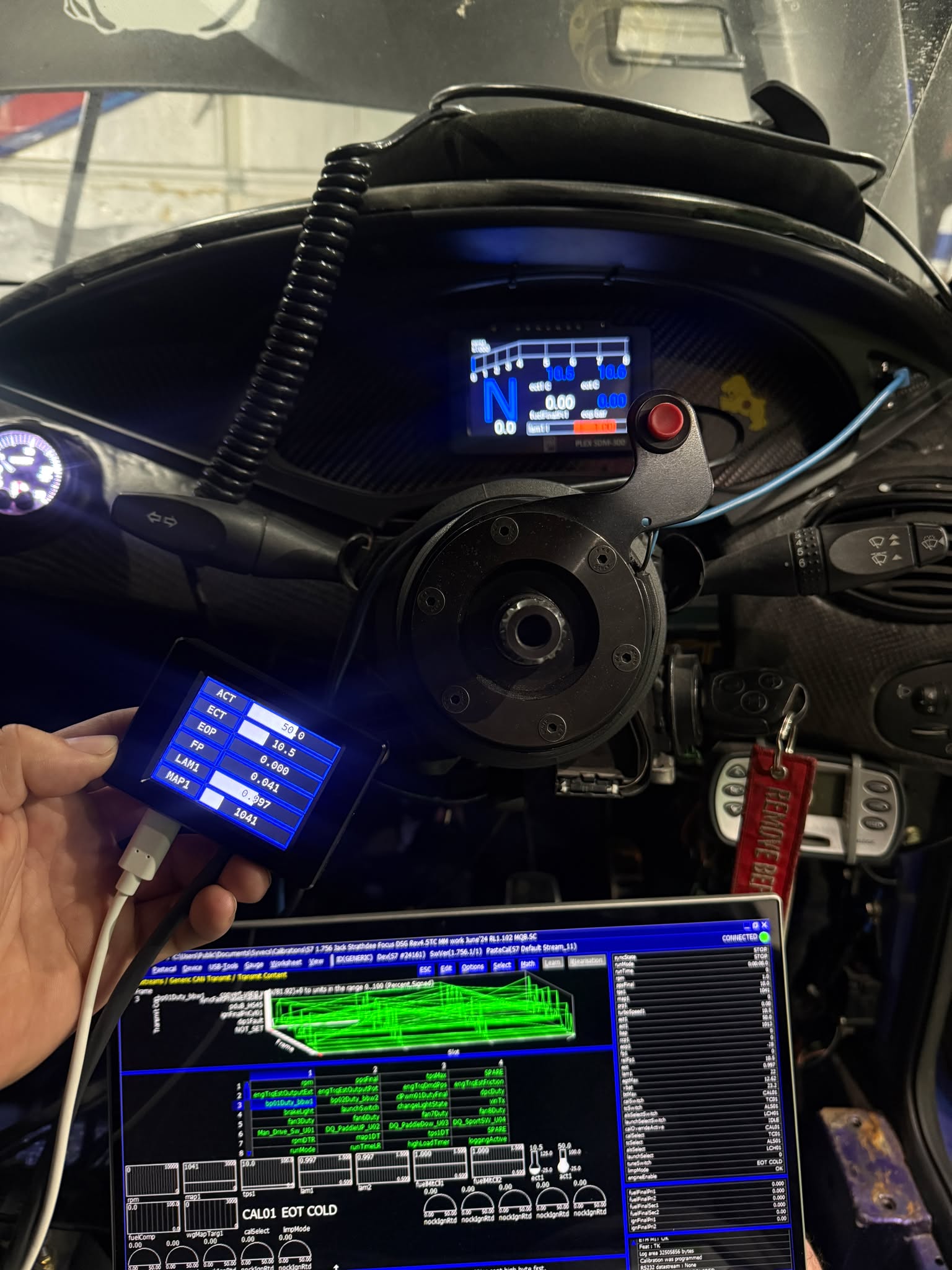

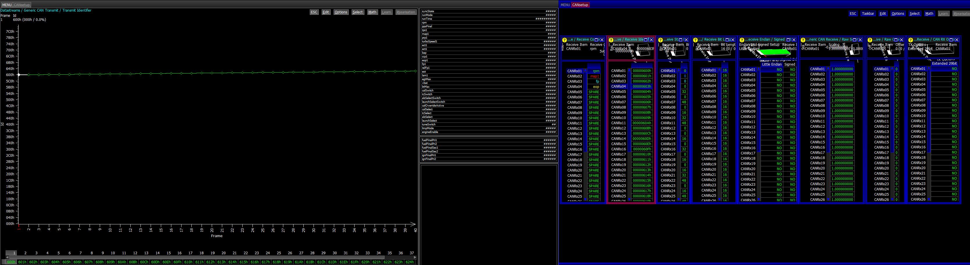

The S7 shows the transmit content as Frame with 4 slots in each frame, where the TD shows just 1 (slot or frame im not sure) - See pic 1
Iv lined the CAN Receive Identifier up so the S7 Transmit matchs the TD Receive but then unsure on how to set the CANRx04 for eop to match? Like how do you know what the identifier is supposed to be,bits ect ect?

There is options for that but like iv attached in the photos it doesnt exactly line up like for like with what is being transmitted from the S7 which is where its loosing me!

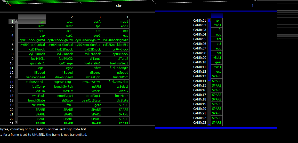

As far as i can see the Receive index is populated correctly (although the value is 0000600h vs just 600h on the S7, does that matter?)
The Can speed is correct at 1mhrz
Iv set all the Receive start bit to 16
Is there a theory behind the frame vs slot? (attached photo)

So, more i thought about it, i am wanting to potentially add the GPS unit in down the line and i have no idea if the plex style transmit content would affect it or not but it made me think maybe i change the PLEX dash to suit the syvecs, so did a bit of digging and to my surprise there was a CAN file for the s7 in the now discontinued manager software! So loaded that onto the plex, Pastecaled the S7 standard stream, the ecu didnt come online! Turns out there was 2 items that went to NOT_SET?? Changed them to spare and then config'd the TD to S7 and boom all works!
I can only guess as i was one of the early customers for the Plex dash's that they hadnt took the time to config the dash for syvecs seeing as you could just config the syvecs to match the dash... all good and well until you add more syvecs products on that can!
