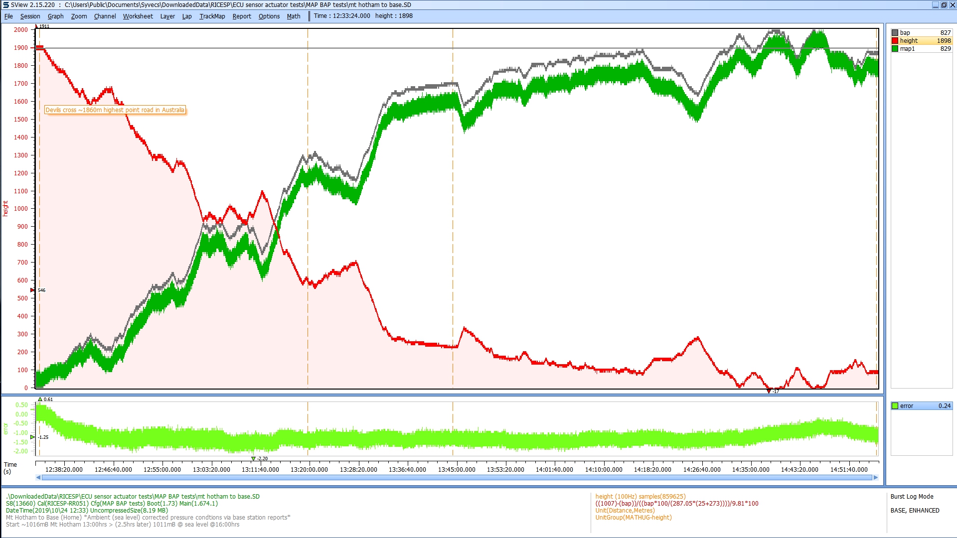

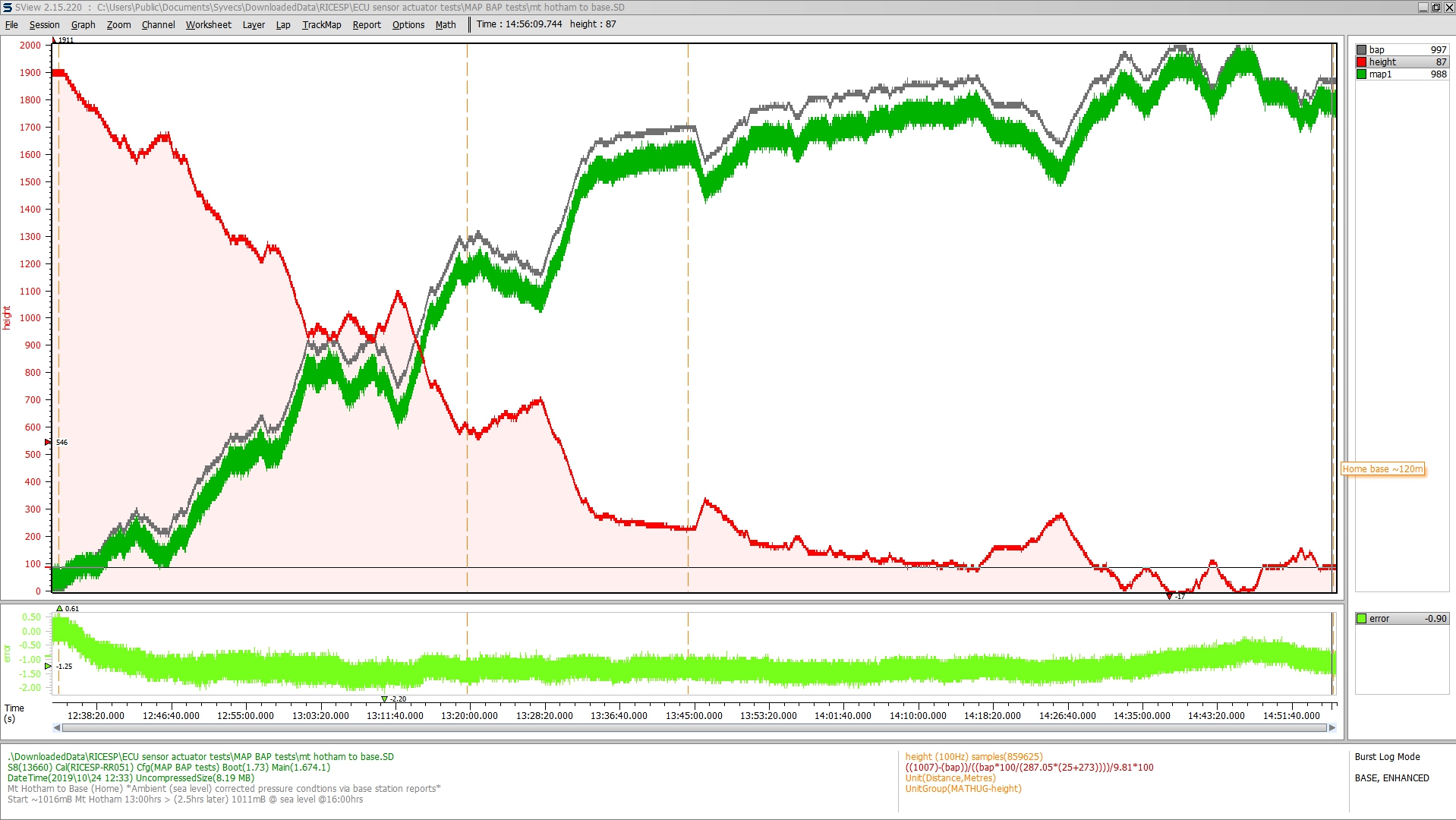

and yes I have driven from sea level to 1850m in two hours to check these things and derive my own altitude to height formula

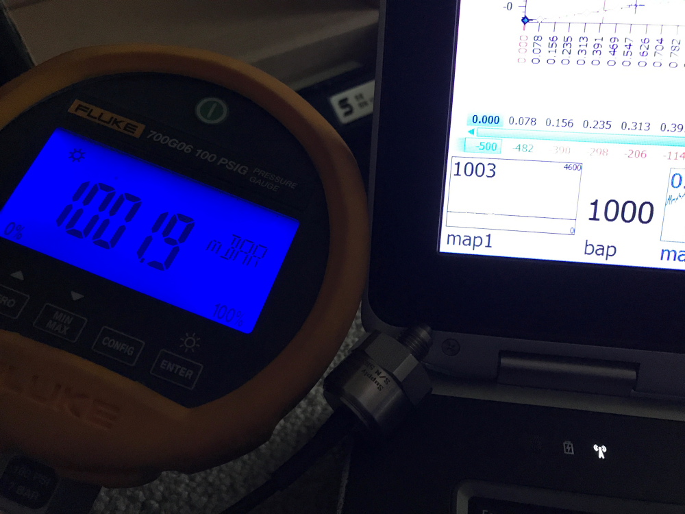

if you have nothing else a penis pump and a reference gauge will suffice as I use to do a long time ago below
penis pump13.JPG (249.61 KiB) Viewed 20597 times
penis pump12.JPG (380.23 KiB) Viewed 20597 times
penis pump11.JPG (387.88 KiB) Viewed 20597 times
