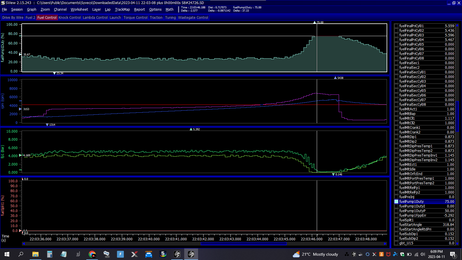

I've got fuel pump DC up to 75% now in the problem area, but seems to be dropping my fuel pressure even faster. Not enough pump? The LPFP in question is a Bar-Tek race pump rated at 800bhp, but not sure now. Lines are -8AN from the pump to the engine and -6 from the reg to rail and -6 as well from reg to hpfp (5 port fpr). New log is attached with increased duty and no split (50% split with this setup triggered a lean limp immediately).
FP Issue Costa 6R.png (167.32 KiB) Viewed 414216 times

So, as Peter was so kind to point out, the PWM control in Syvecs for the LPFP is inverted. I flipped the p component in reverse (adding up to 50% for positive error and removing up to 50% for negative error) and it's smooth as glass. Until now I didn't find any documentation that stated fuel pump control was flipped, so let the record state!
I've still yet to bring the port injectors back in, but I will update this thread with final notes.
