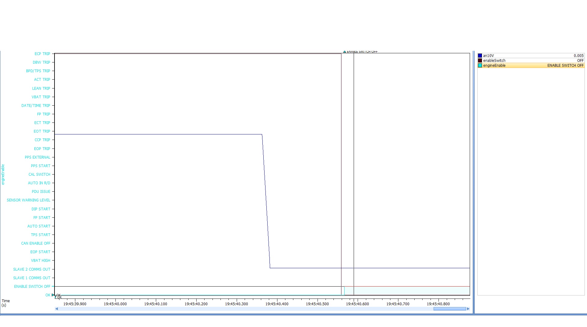

Posts: 1422
Re: Engine Cut for cartek XR
testing mine ( must admit, haven't before )...
engine not running, not starting it for the sake of a test just now.
Key on, ecu live etc.....hit kill switch.
Goes from 5v to 0.005v, around 0.175s later Enable switch goes off, then 10ms later Engine enable goes to OFF
And roughly yes 0.5s after I hit the button the log stops, all power shut down. This is exactly as stated by Cartek's timing.
Not sure what causes the 0.175s delay from the kill push, to Enable switch recognising it.
kill switch test koeo.jpg (150.97 KiB) Viewed 33255 times
