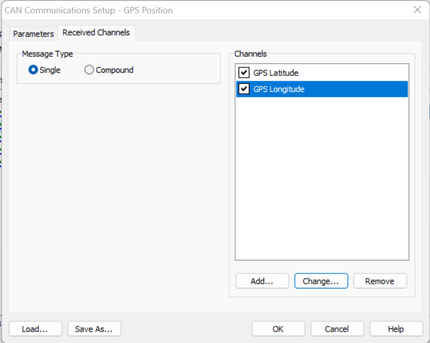

I am trying to program/wire two separate Syvecs 50Hz GPS Receivers into the same CAN bus running from a Motec C185 dash.

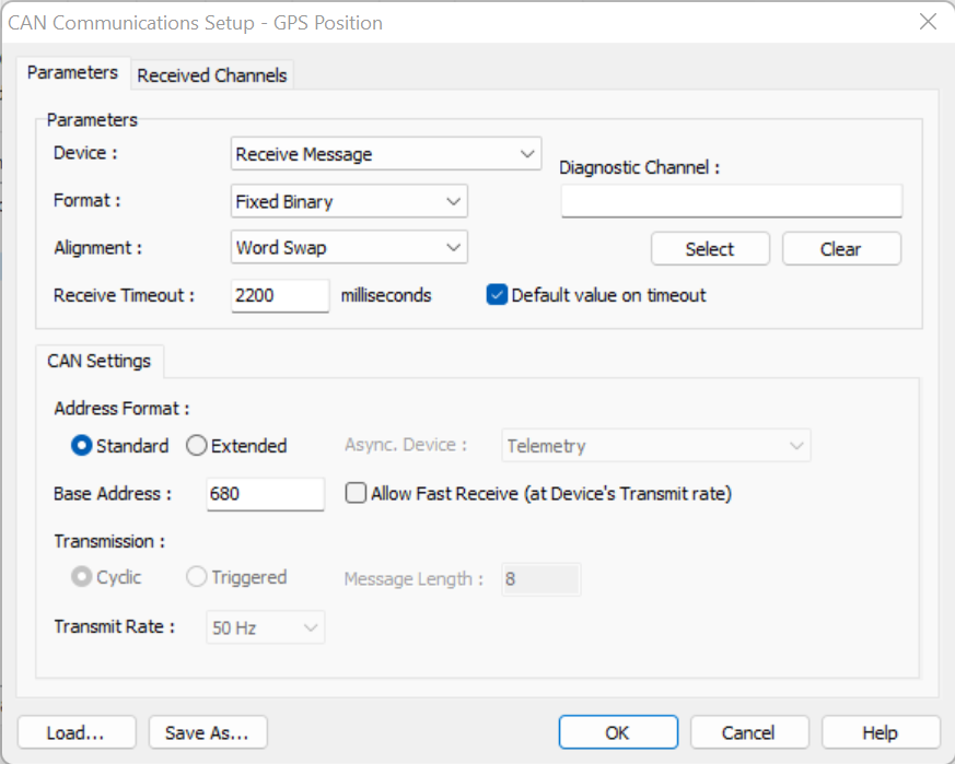

The problem I am running into is that both receivers use the same Base Addresses for their transmitted data.

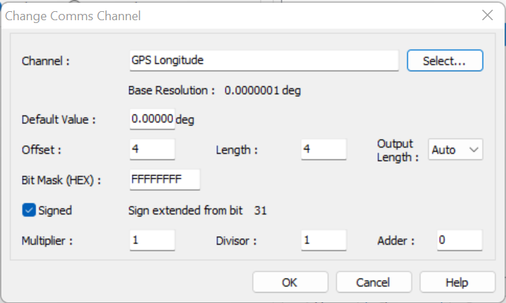

I have tried adjusting the received message timeout for the second receiver as well as changing the received data offsets, but still appear to only get data from one of the receivers, or potentially an unknown mix of data. I am unsure of any other ways to change the priority and order of received messages.
Does anyone know if what I am trying is possible? I would prefer to keep the receivers on the same bus if at all possible. I appreciate any help or feedback!
Here are the current C185 Coms parameters which work with a single receiver:
Re: Motec CAN Programming for 2 Syvecs 50Hz Receivers
Only way to differentiate between the 2 GPS receivers is they each transmit data using unique CAN IDs. There's nothing you can do at the MoTeC end to magically distinguish data that is received on the same CAN ID from 2 different devices.
I don't think there is a user interface to change the CAN IDs on the 2 receivers so easiest will be to use 2 different CAN busses.
