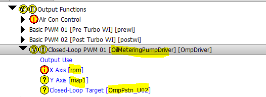

i just got a S7+ from Chris and i also want to keep the OMP in my 93'. Can you share your Cal and IO Pin assignment?
I tried to come up with some sort of Functionality that is already in the ECM to cope with OMP Control but i still struggle with the outputs.
The OMP Position is basically a Custom Sensor (OMP_Pstn_U02 in the Screenshot) and i added a CL PWM Table on top to Control the Bipolar Stepper within the OMP.
In the Pin Assignment though, i can only add one output as a H-Bridge to Control the OMP but i would need at least 2 to run it as a Bipolar Stepper and i think 4 if i want to run it as an unipolar stepper like the factory ECM does.

The FD i'm building is somewhere between weekend racecar and Street Legal (under german laws...). I premix but i just wanted to have the OMP as backup.
Chris Ludwig has the patched Software from Syvecs to run 2 H-Bridges to Control one feedback input from a Sensor so it shouldnt be a huge deal to get this feature permanently in all upcoming Softwares.

Coming back to the OMP control, i'm premixing now but i still want to go back to OMP + Premixing for the simple reason that i need an Overrun fuel cut to stop the car from misfiring and / or spitting flames all the time but in this case there will be no lubrication at this point.
Can somebody from Syvecs maybe chime in with some ideas how to fix this?
