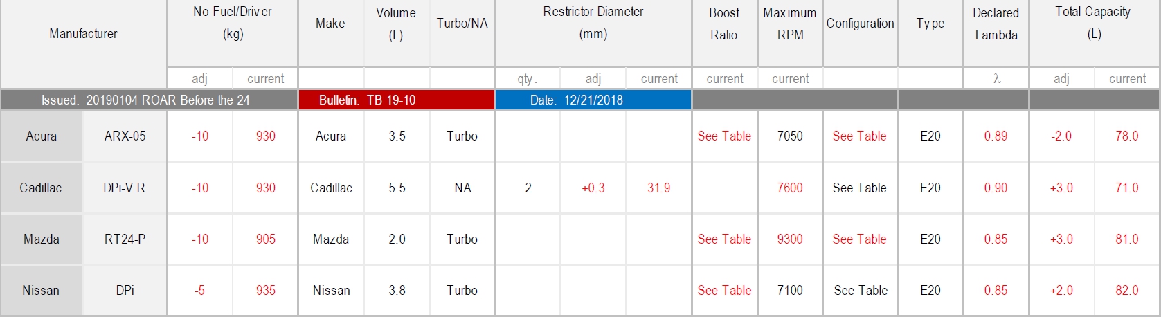

The AER developed Mazda 2.0L Turbo engine used in DPi is homologated at 17.65% excess fuel rate for people interested :)
Eq ratio of 1.176
Re: Lambda to afr
Will take your word for it - can't see anything on that image with those numbers
Posts: 524

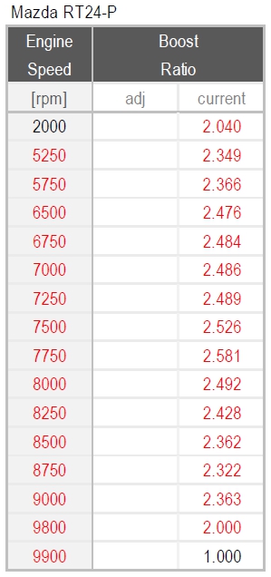

Re: Lambda to afr
Details here (Life racing ECU aka Syvecs)
facts 5.jpg (245.48 KiB) Viewed 38172 times
facts 4.jpg (91.78 KiB) Viewed 38172 times
