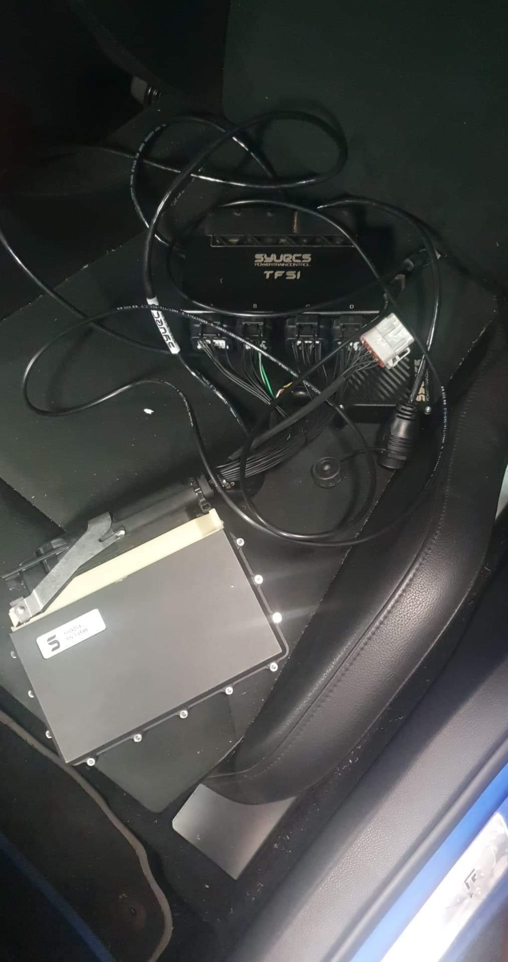

i have been trying for a year to resolve a issue with the can-bus issue. i bought a S8 ecu second hand from a private sale. i had a shop try to make it work and then we found out from syvecs it was the wrong ECU. we then got a new one sent out which had a TFSI connector before the S8ecu its self. we tried that ecu and we still are having the same issue.
From my understanding with the issues
1st S8 ecu i got, car would not go into drive,reverse its couldn't talk to the can-bus/DSG
2nd S8 the new one. car will go into drive ,reverse and in 10 sec cut off and have a can-bus fault
we put the factory ECU on no problem drove the car home after 1 year in the shop
old ecu s8.jpeg (107.63 KiB) Viewed 30860 times
new ecu s8.jpeg (93.05 KiB) Viewed 30860 times

I'm probably wrong...but I thought in a lot of cases for OEM integration with the likes of DSG, the S7 range had the correct comms stuff built in ?
Not the S8 range ?
The S8 will certainly run the engine though with appropriate GDI drivers etc.
