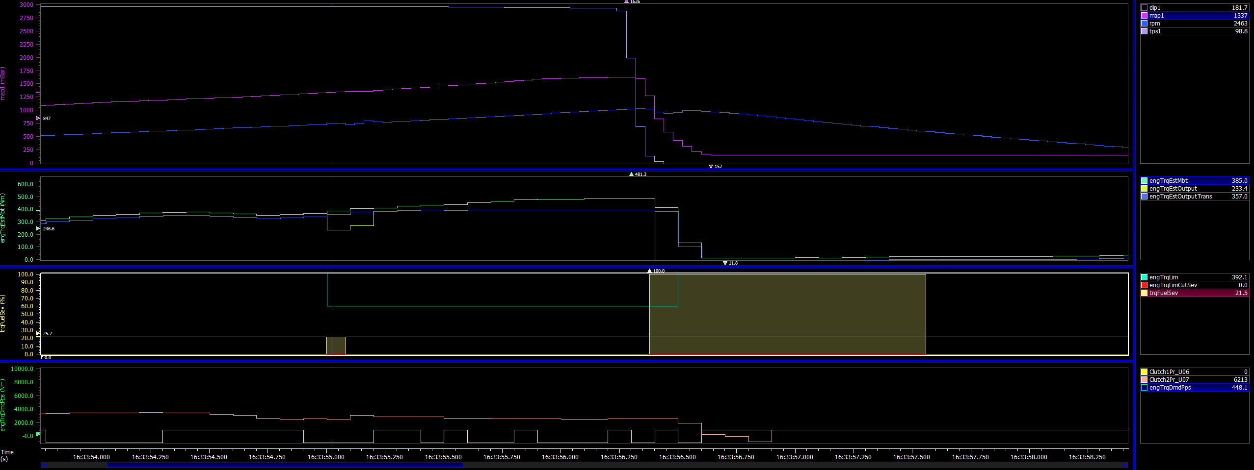

Thank you for your response. I need to figure out how to shorten the clearing time because during that time trqOutput to the trans is ramped back in too slow.
Here's a screenshot if it's helpful at all:
Annotation 2019-02-01 085008.jpg (201.22 KiB) Viewed 37987 times

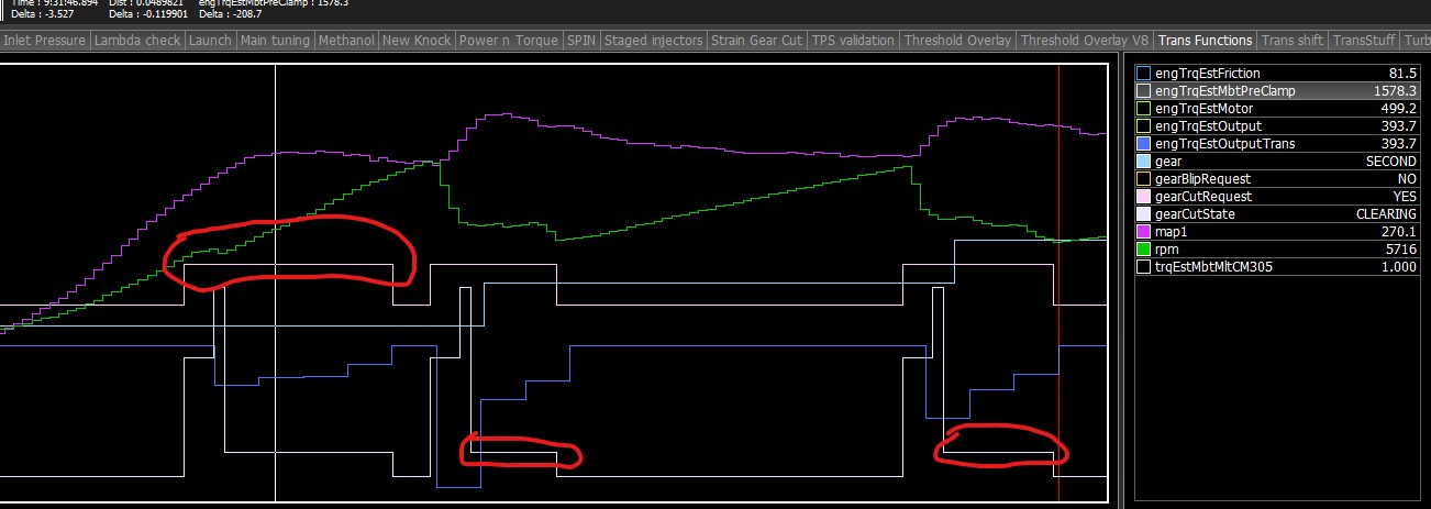

Upon further review, it's looking like there might be something wrong/flaky with the gearCut/blip request. I have a log earlier showing a gearCut request during a pull in 2nd gear.

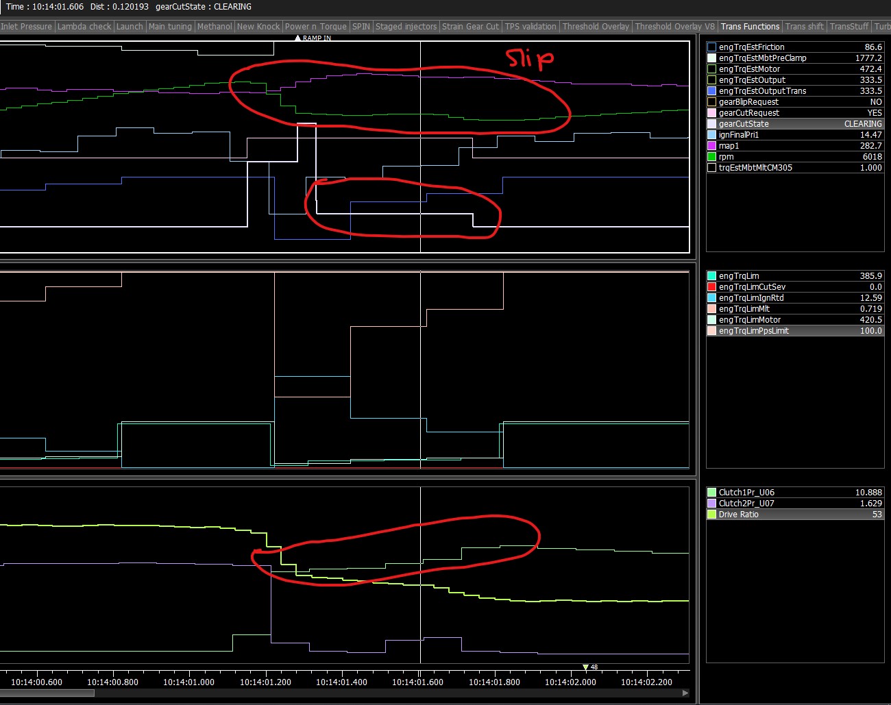

nick, did you figure this out? could it be the clutch is actually slipping? I have the same issue which goes away when I lower shift rpm point. as I increase shift rpm the clearing state takes along time and shift time increase, this issue increases with rpm with me.
