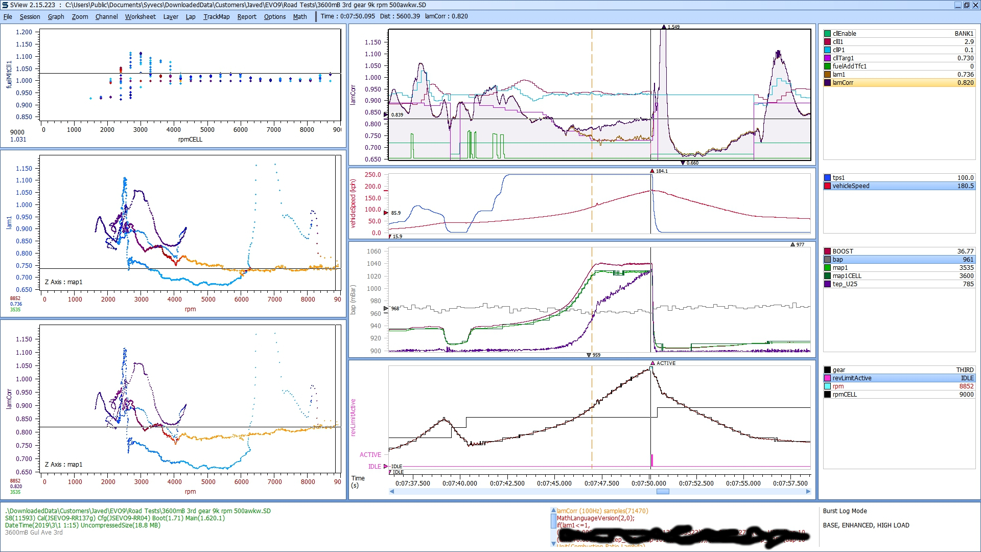

Pressure compensation, live action.
Done live via ECU/Dash or post process in analysis.

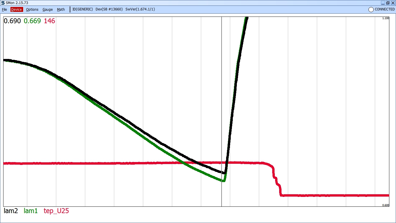

FYI to others wanting to do this (on bench). The latest firmware now allows you to keep the heater on (permanently) so no more need to keep powering up the ECU to drive the heater at 20V (max 30 seconds), also you can adjust the heater in run to a voltage to equal heater element intensity on your reference/calibration NTK meter as well.

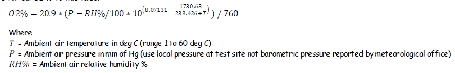

Posts: 537
So here is the technical info for those who want to do this.
The errors are more extreme as you get to upper end of lean and lower end of rich scales, so if you for example dont do this or have a reference meter that is shit then it can be over 15% wrong! on a Diesel for example or on an extreme boosted engine running full rich over 7% wrong.
O2 formula.jpg (71.06 KiB) Viewed 167730 times

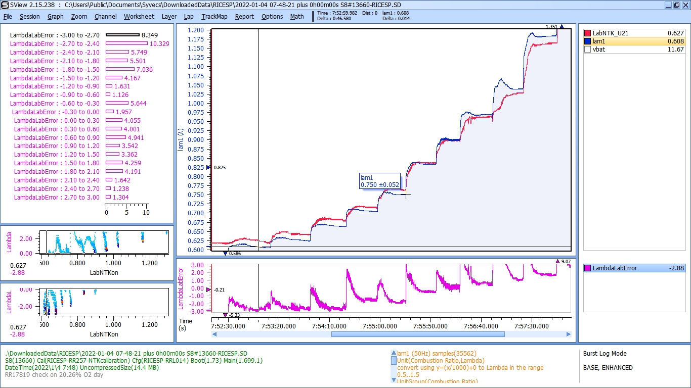

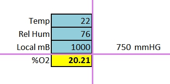

Posts: 537
Here is the adjusted sensor report/cal test.
If doing these each day the cal is run the reference meter needs to be updated to account for test atmospheric conditions, if you want it to be ultra accurate.
For most performance car shops this wont matter :lol: as they only look at their sensor when it stops working ! let alone understand how it works in most cases !
Correct DON.jpg (766.39 KiB) Viewed 167730 times
20.21 percent O2 cal.jpg (24.59 KiB) Viewed 167730 times
