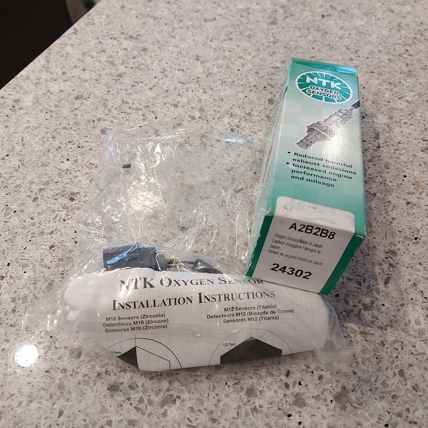

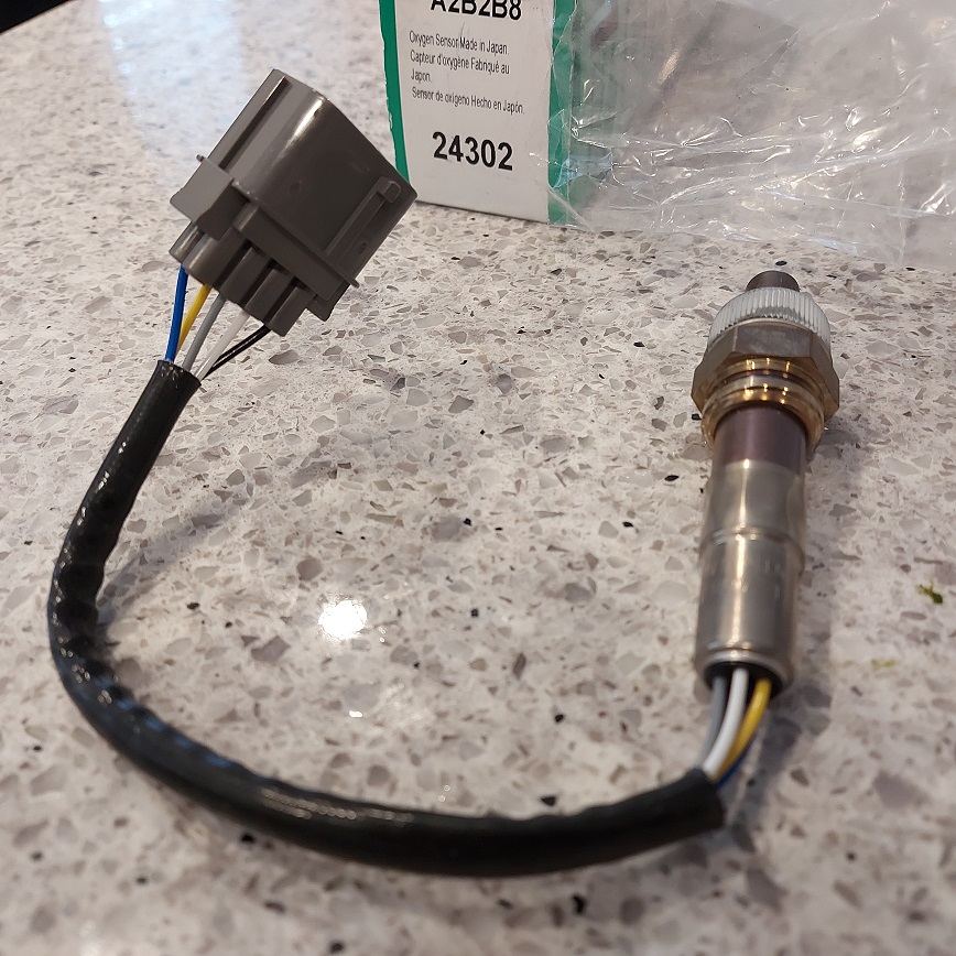

I have a spare brand new sensor sitting on my shelf. Part number is 24302 which I don't think is the L2H2 and not sure if that would even work with the Syvecs. I believe the L2H2 is a 24300 part number.

Re: Wiring in S6 GP
Thanks again for the quick reply.
The links didn't work but if I'm understanding what you're saying correctly, the sensor I have (pictured) would work and is potentially a L2H2 sensor?

- Posts: 1407
Re: Wiring in S6 GP
The links do work,
But it may or may not be the same...Safest is to buy the correct one known to work.
