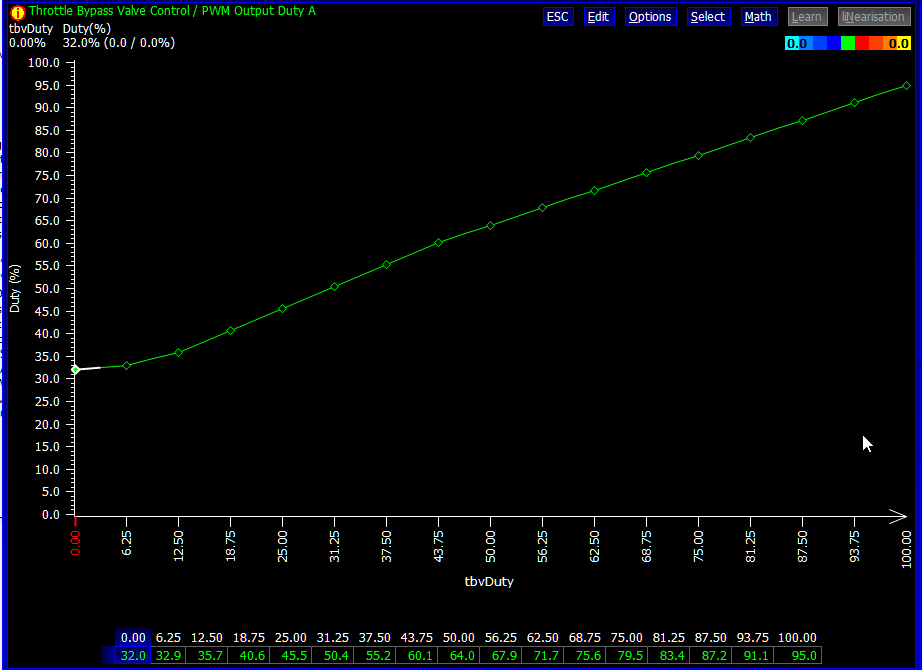

I used 300hz on a 2wire valve, it absolutely needs a flyback diode to work properly. My PWM output looks like this:
bosch 2 wire.png (31.13 KiB) Viewed 130597 times

Because an idle valve is a proportional device.
The diode stops the back EMF, (I think) the back EMF from the collapse the magnetic field will effect the field being reestablished during the next pulse, so you're average field strength is reduced. What we want is a more of an averaged constant current and therefore steady field of a required strength.
For a solenoid it doesn't matter because your back EMF occurs after the solenoid has moved and you don't care about the effect on the magnetic field between pulses.
Poor explanation but for proportional devices (ISCV, Electromagnets, Oil control valves etc) you want a diode and for solenoids that move from one state to another (injectors, boost solenoids, ignition coils) you don't want a diode. I would also use a diode for very big heafty coils like strong actuators, nitrous solenoids etc, because the back emf is just so big and risks damage.
