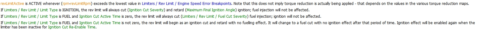

How do you have the fuel cut severity set on yours ?

the issue: rev limit set to fuel. but the ignition cut was still being used. i by mistake by not looking at the "ignition cut active time" it was st to 2 secs put it to zero. and all of a sudden the engine was really happy and smooth with no knock being recorded.
so even with the limiter set to fuel type, it still references the ignition cut.

yes yes. should of gone to spec savers.. still doest explain why it hates an ignition cut..like really hates it. il fine tune it abit more. but that was just revving it in the workshop,
with the ignition cut, it was building alot of boost, and the more boost it made the more knock i was getting when the ignition was coming back on.(each big bang out the exhaust would trigger the knock, i have it on the dash as a warning flag) also, almost solid mounted engine shaking the car pretty bad.

As said...when there is an ignition cut, presumably also if fuel is not 100% cut at that time you're throwing a lot of unburnt fuel about.
Fuel...air...heat and off/on ignition is going to make bangs.
If you're cutting all fuel, or even most fuel but spark/combustion could potentially continue even in a very lean but safe form in the chamber...then it should be pretty quiet.
I'd say the problem is simply raw fuel in all the wrong places.
