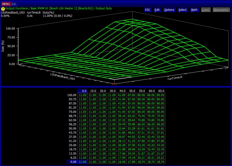

So - new LSU4.9s are here and I think I settled with a heater initial heating strategy using runTimeLR as I previously mentioned.
This strategy should meet the criteria detailed on the 4.9 data sheet which states 1.5v max during dewpoint phase (@ TimH - you mentioned 2v max here but UI've not been able to find any ref material suggesting the (slightly) higher number).
The data sheet also seem to indicate no ramp up is needed to the initial 1.5v so I've gone with that but then a jump to 8.5v and then a controlled (0.4v/sec) ramp up to operating voltage (13v) .
I've avoided the sudden jump to 8.5 volts and in stead ramp it up at 3.5V/sec (assuming 13.5v is 100% duty).
In fact the theoretical max in this cal is 80% duty so around a 10.8v.
Now as my output duty calcs are based on the logs of vbat (always aroung 13v and somespikes up to 13.5v) I may be a little out here - I'm not sure if the syvevs 12v outputs are capped at 12v or whether the follow vbat - I'd certainly be interested to know.
Below is the current table I'm using for this strategy - I guess time will tell if it's good or not!

- heater_control_runtimeLR.JPG (101.64 KiB) Viewed 93924 times
