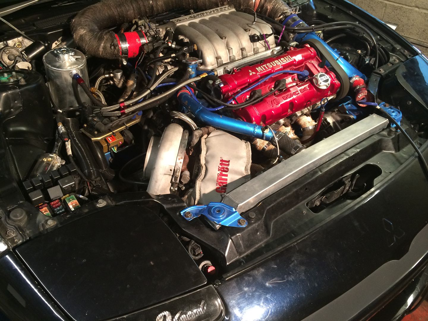

I'm currently researching what benefits the Syvecs and other modern/up to date ECU's offer over my current Omex 710.
I've been running an Omex since 2004.
There weren't exactly a plethora of stand alone choices when I ordered mine in December 2003 and I was all set to buy a Motec M800 but I went for the Omex700 after seeing a demo of it by Chris Todd who was, at the time working for Power Engineering. His tuning and extensive expertise/support were my deciding factor.
I've been very happy with the Omex (which was upgraded to the 710 version for free) but I now want some more advanced options.
My requirements:
Do everything that the Omex can do including running 6 sequential injectors and 6 individual coils (or 12 cylinders sequentially if available - the Omex can do this).
EASY and COMPREHENSIVE logging options available to be displayed ideally on an iPad (or similar) mounted in the car.
A full gauge display option that I can display/mount in the car, again ideally on an iPad.
The car:
Mitsubishi GTO 3.6L GT42RS
Currently 900 BHP but turned down to a conservative 800 BHP for Time Attack.
I'm expecting 1200 BHP when I fit my new headers, use NOS and 100% Race gas.
What ECU were you running before going to the Syvecs?
What have you found to be the most limiting factor on your Syvecs?
Mark ;)
