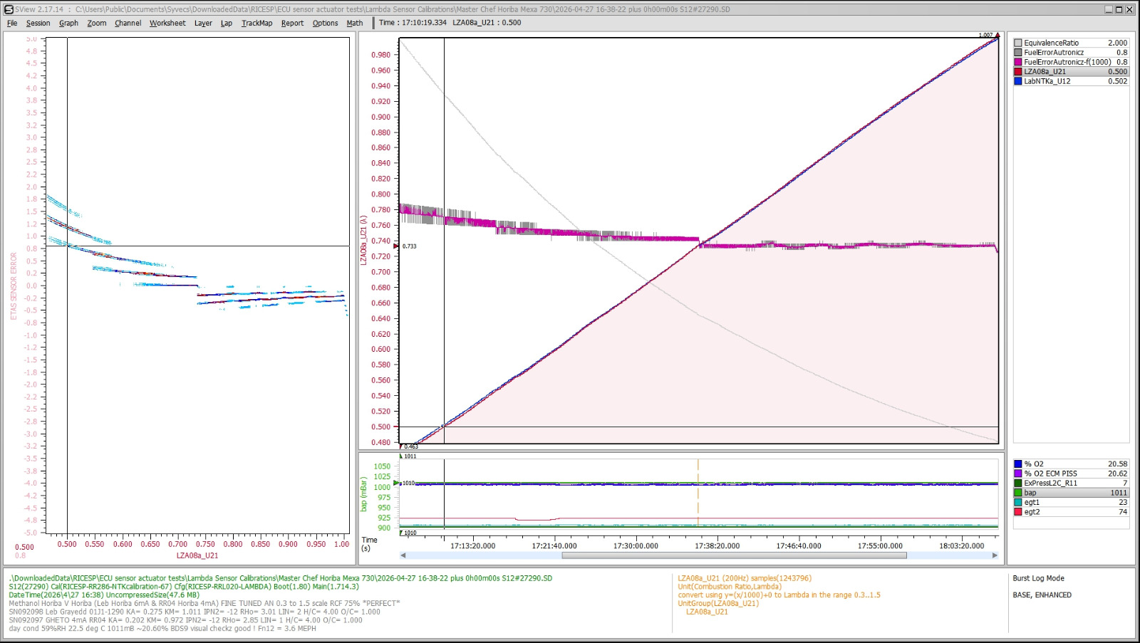

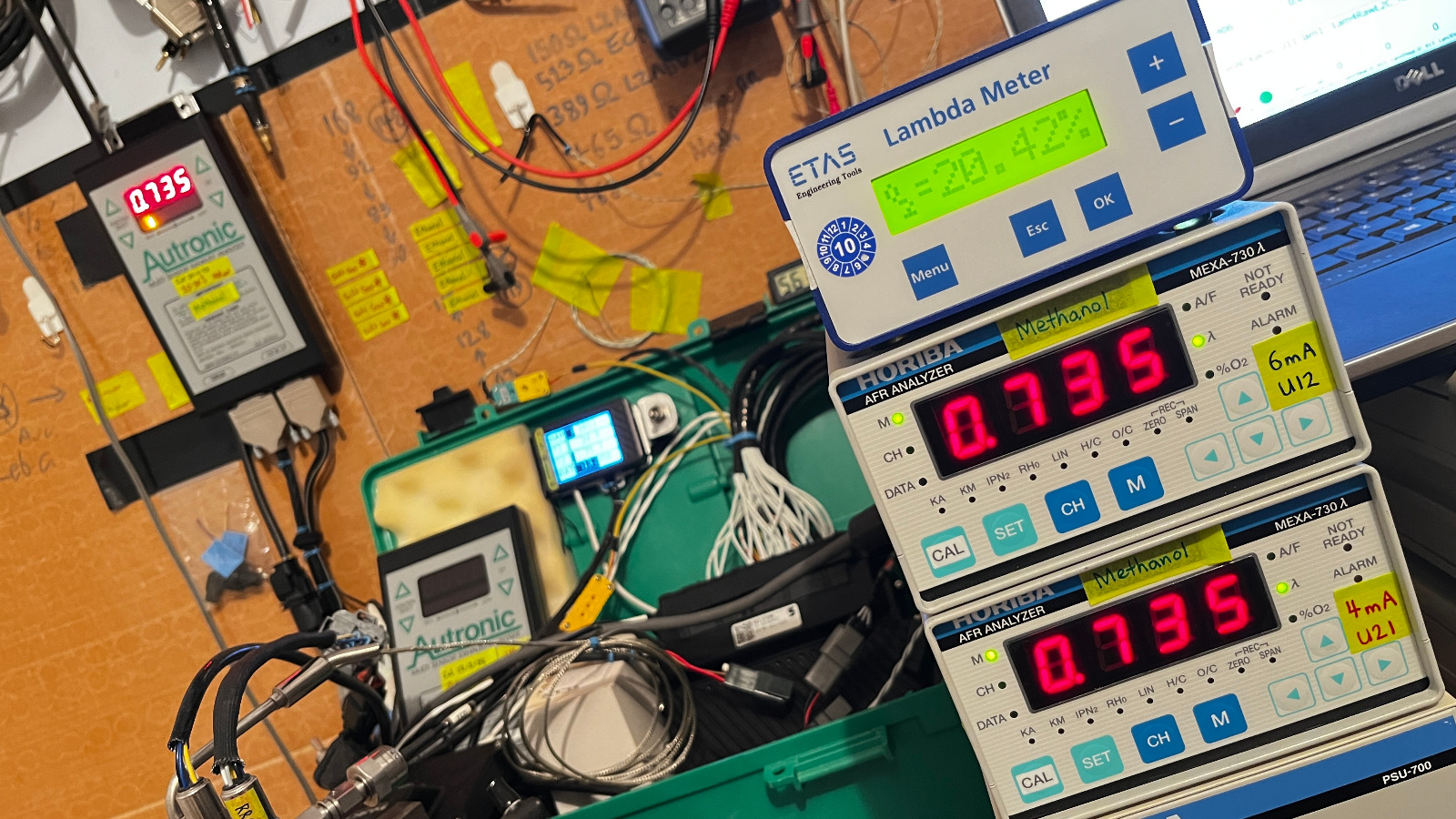

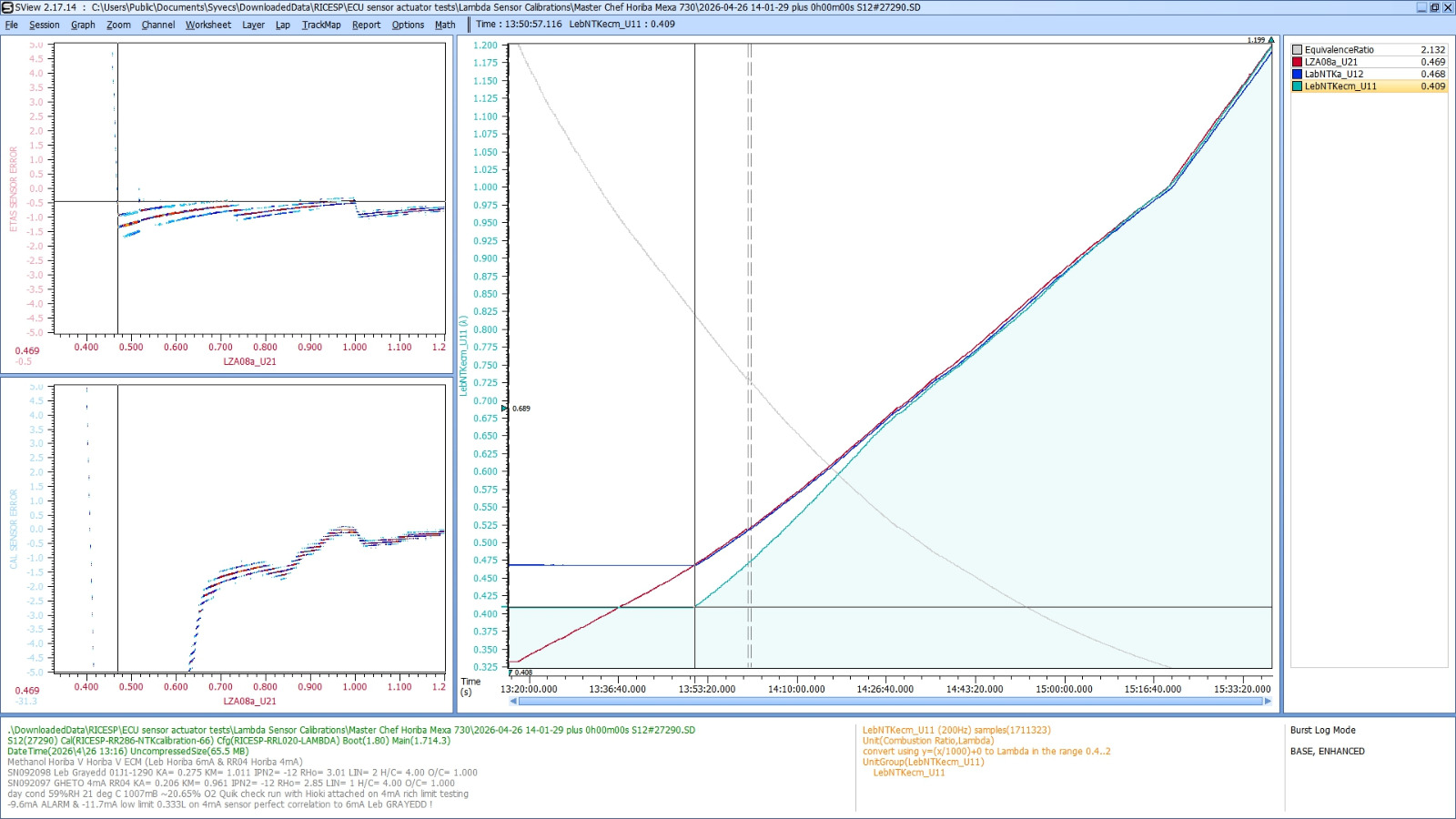

How rich can you go?
This is the RR04 banded LZA08 sensor as I supply now for a long time off the shelf fitted to the Horiba marked with the 4mA sticker compared to the $1580 USD supplied factory Horiba NTK sensor, set to to read in logger better than 0.001 accuracy in full test span range (what is on screen is exactly whats in logs).
They are as close to perfect as you can get.
Rich range down to 0.328L or so depending on conditions and fuel type being tested, this is on Methanol. Where this is pertinent is pre turbine application where the partial pressure sensitivity at high TIP means you do actually need this rich range so the lamRaw can go low enough to give you an actual lam1 true value in a device like the Syvecs 8 channel lambda to can unit.
Of interest to some is the fact that my ECM 4800P units with factory new calibrated sensors and ETAS LA4 with factory delivered LSU all overlay to each other in common mixture ranges (0.650 L and higher) once set to correct ambient conditions of pressure temperature and relative humidity, as does the RR speced BDS9 Autronic work horse donmega meter to end all shop meters.
If you want to actually have a trusted calibrated NTK sensor for your Syvecs LR gear then feel free to reach around to me :)
