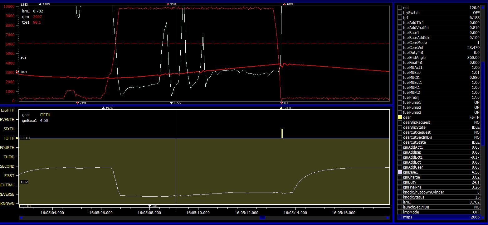

After I wanted to vote on the highway, I noticed that the engine is sporadically jerky in high gear ratios and bangs out of the exhaust.
This can also be seen at the lambda LOG (see picture)
Fuel table and ignition table fits, does not ring or somewhere is missing.
I have already exchanged spark plugs and ignition coils, but the fault is still there.
it can possibly be at the injection angle that has the problem?
or DIP Opening time?
Log I have also uploaded
in the log you can often see that the lambda jumps and the motor jerks at the same time

s8 tfsi engine jerky

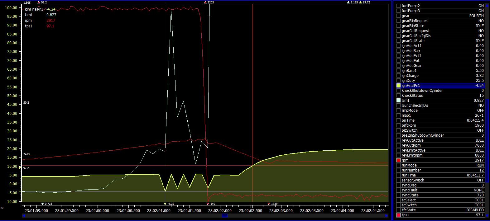

which I also just noticed that the ignition goes to minus, however, do not find the correction that changed the ignition value

Ignition timing low values could be knock control or something but you are not logging anything relevant to that to see.
As for the fueling side of things...with fuelbase and fuelfinal recording zero a lot of the time...I havent a clue about that !
There must be some other important parameters to be logging with regards fuel for a DI engine.

because in the picture for example, one sees that the ignition goes to minus
in the appendix still a picture
the syvecs should actually record all parameters or not? or can I adjust what you want to log?
I think it is in ignition parameters but I find unfortunately nothing.

SO the log function I have now synonymous adjusted, the fourth cylinder has knocked.

I was just having a look at the log, and when the lean spikes occur, the Knock logging gets triggered, although it doesn't show any cylinders being cut. However, knock control seems to be retarding the ignition.
- Posts: 1422
Re: s8 tfsi engine jerky
Slowie wrote:I was just having a look at the log, and when the lean spikes occur, the Knock logging gets triggered, although it doesn't show any cylinders being cut. However, knock control seems to be retarding the ignition.
He isnt logging anything worthwhile to tell what knock control is doing.
